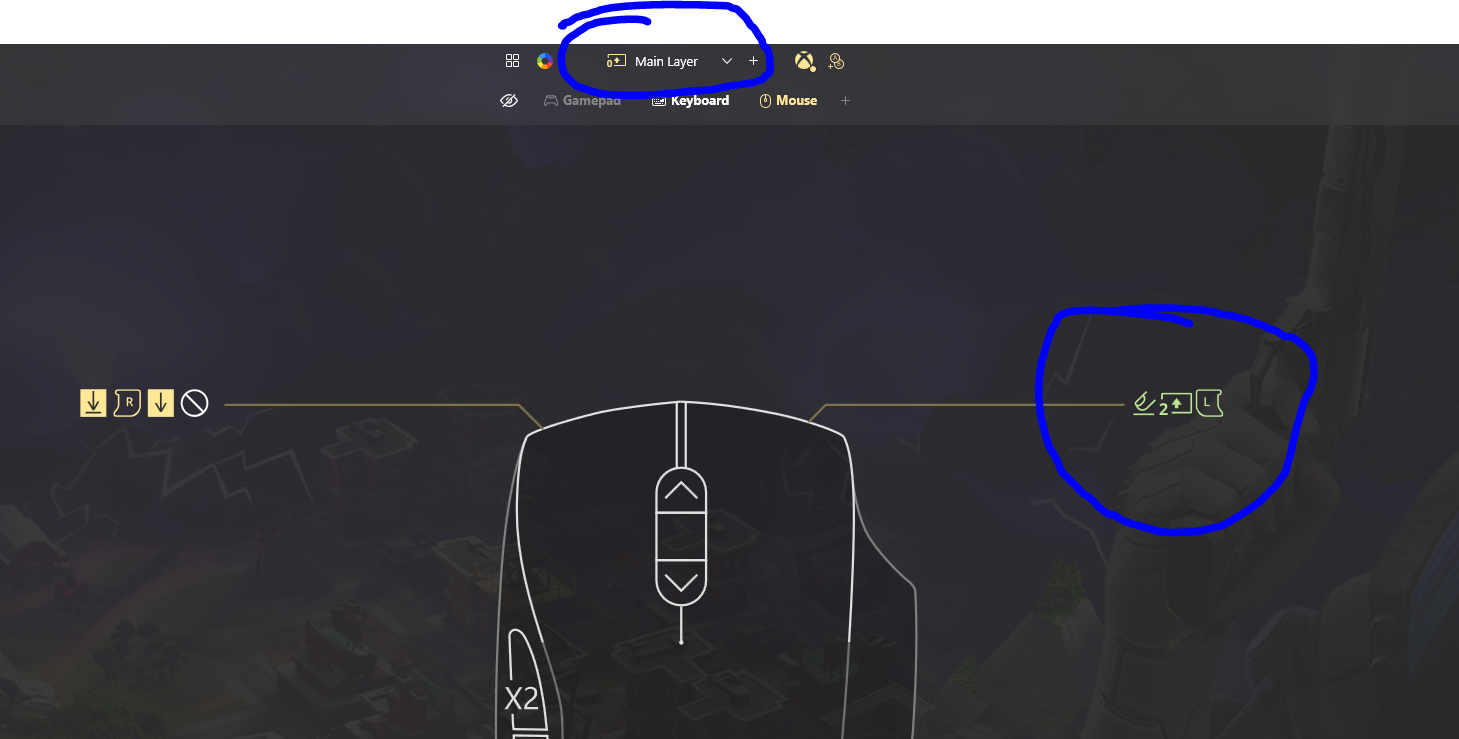

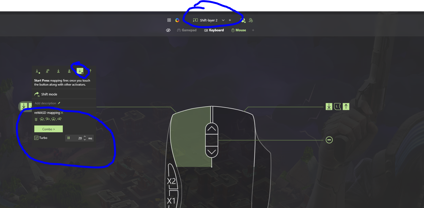

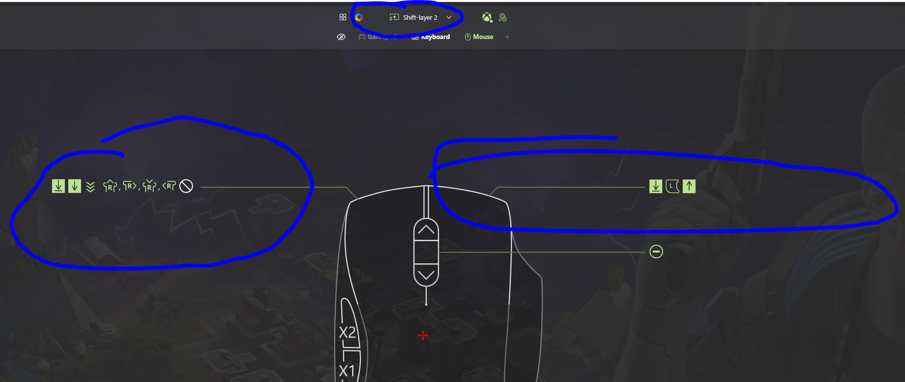

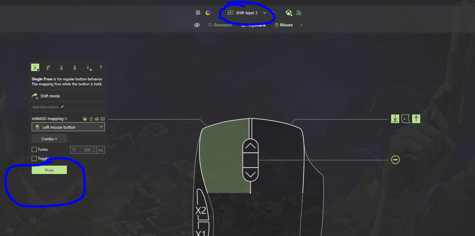

    Hello, im using Rewasd and have studied all settings. I have created my own "perfect" template for gaming. But im facing a great issue. I cannot left click when i right click first(aim down sight on hold to send to shift-layer 2), and in shift_layer 2 i signed macro to left mouse click. And in game it didnt react to left click a few times and i have a really bad game experience(missed lot of oppertunities to first aim and kill). I also put the left click on Mute to reduce latency. But it doesnt work. I can only share my file privately because it took me 1 month to create this template and im not ready to share it because it would be used by some people that is selling the template(i have created highest sense of aim assist on max).
    so, in summary. My problem is that left mouse click has no reaction(60% rate in every game) in shift-layer 2 when i left click(aim down sight in main layer). Maybe its wrong with my macro setting with left click? Turbo and 20ms pause?

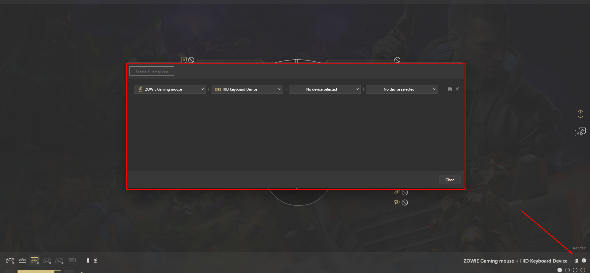

    Could you send us a screenshot of your device's group editor and the config file?
    Your configs are stored here: C:\Users\Public\Documents\reWASD\Profiles ​​​​​​​I need the correspondent *.rewasd file.​
      Your configs are stored here: C:\Users\Public\Documents\reWASD\Profiles I need the correspondent *.rewasd file.​
      Is it fine if i change values(sensitivities and macro values) in my config file so those people wont use my original file to make profit. And what is Device's group editor
        He means the tab where you can add and see the devices in your group.
