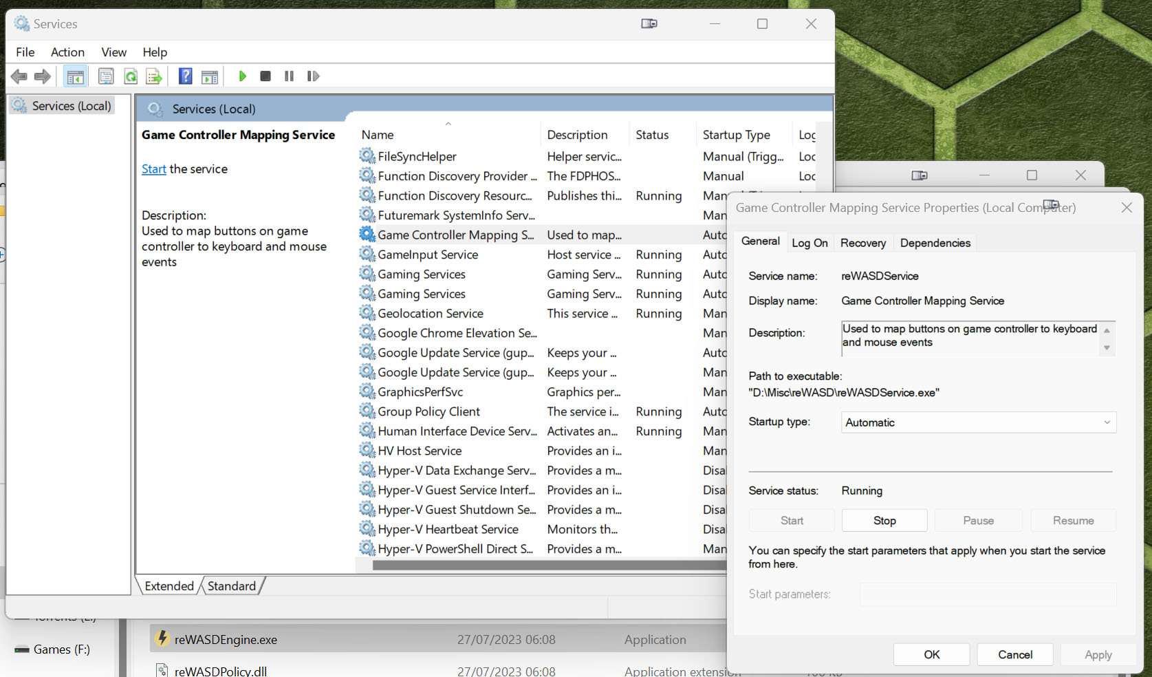

    When you got the Error: -1 message, please open Services, find the gamepad controller mapping service, and right mouse click and check if the service is running (http://dl3.joxi.net/drive/2020/06/15...82a0d48889.png). Please run it manually if it's stopped. Are there any error messages popping up after manually starting?

      I check the services and it was running ( set to Auto ) i closed down reWASD and the service stopped. I then hit the reWASDEngine.exe and the service started again and it loaded up as normal.
      If i restart the system reWASD will not autostart , if i hit the reWASDEngine it gives me the error, if i run reWASD.exe the app opens as normal, and nthgen if i hit reWASDEngine that also runs as normal. Its as if something is stopping it from starting on bootup

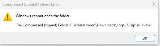

          In that folder there was no logs.zip or logs.rar i had just a bunch of files that i have zipped them up for you.

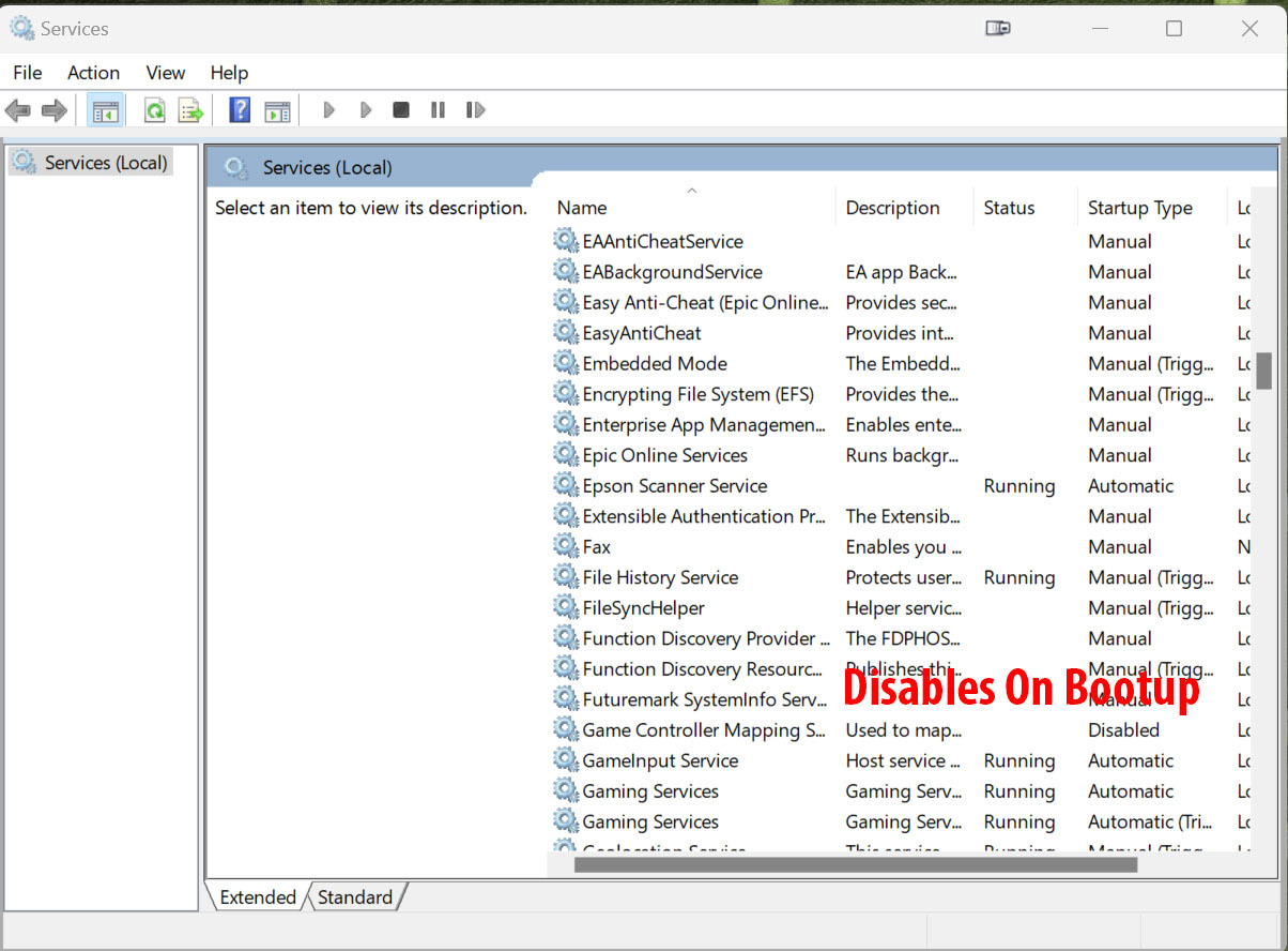

          I noticed pon bootup the service is disable, if i set it to auto reWASDEngine works , but on a reboot the service is disable again ( uploaded an image to show my service on reboot ) .
          Its as if its being disable on bootup even if i set it to auto then reboot , it still is disable on startup.

              i will rezip them , but there is no logs in there they are blank i also uploaded a jpeg to show that it disables on startup ( services and in the startup folder )

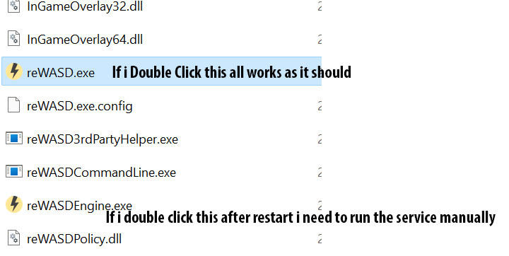

                  i can start the service by executing the rewasd.exe file and everything works as it should , even after a reboot.
                  If i try to execute the reWASDEngine.exe after a reboot i need to start the service manually.
                  If i execute rewasd.exe after a reboot all works as it should , the service is set to auto and i can even execute the reWASDEngine.exe with no problem.
                  Its as if something is disabling the service on startup until i either start it or set it to auto manually or execute reWASD.exe.

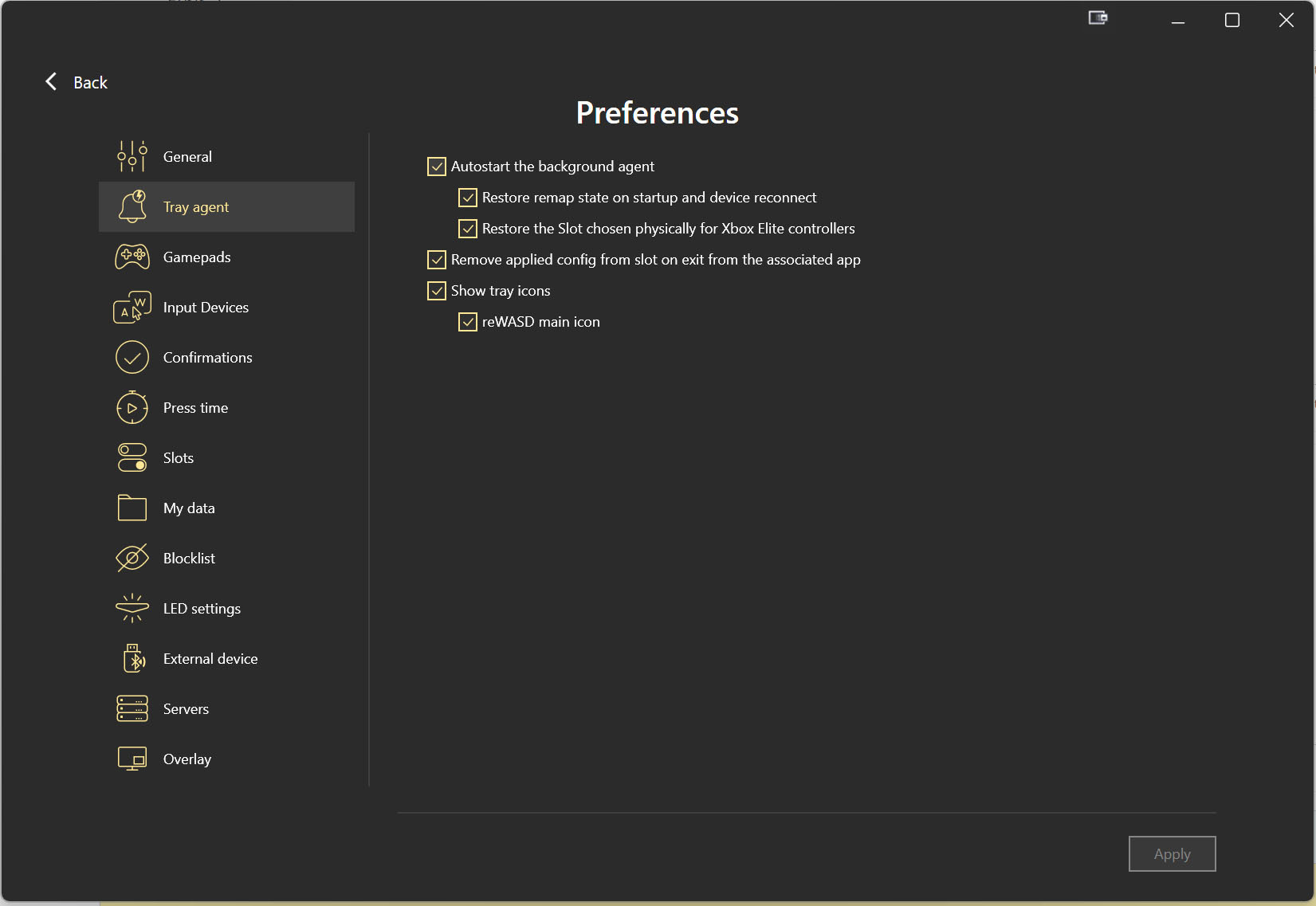

                          Have you checked Autostart the background agent​ option in Preferences?
                            yes it was checked
