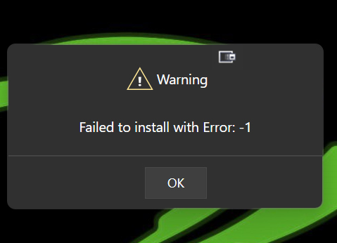

                    There is definitely something on my PC that's stopping it i just can't figure it out , i managed to try and get it to start on start up but got the " error to install 1" , error again so i have no idea whats going on. What is confusing is i can start the app manually after boot by double clicking the ReWASD shortcut it just won't run on or during system start-up.
                    • #25
                      When you got the Error: -1 message, please open Services, find the gamepad controller mapping service, and right mouse click and check if the service is running (screenshot). Please run it manually if it's stopped. Are there any error messages popping up after manually starting? Please take the screenshot of them.
                      • #26
                        Checked gamepad services , it was disabled . I right clicked went to properties and selected manual , then i clicked start service and it started as normal.
                        thats the error i get on bootup

                            I honestly think a system re-install will fix the issue i don't think its the app thats the problem i think its something my end, I only use it on 1 or 2 games so i think i have a solution and i think it should work.
                            Can i edit the shortcut of the game i use it on to execute reWASD exe file 1st and then the game exe second or would i have to create a batch file to exe cute both apps and if so how would i create the batch file.
