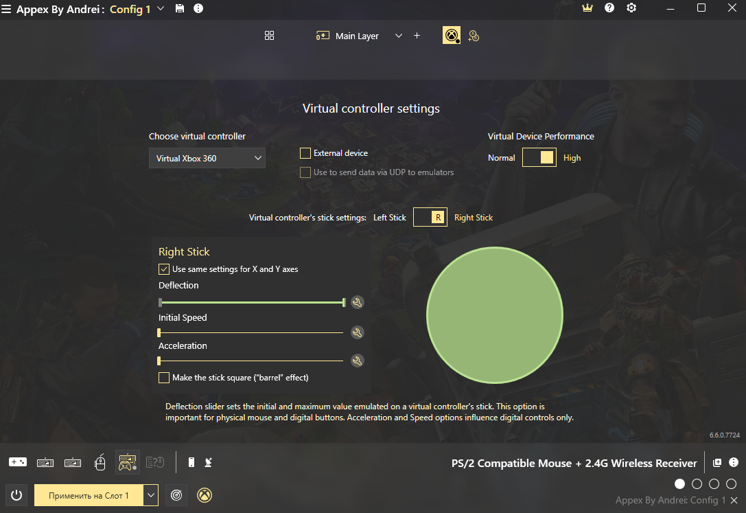

    3.1 - In the DS4 i see: Use to send data via UDP to emulators - what that? When enabling this feature, I noticed that the sight moves strangely when shooting, but I did not understand what is the advantage of this feature

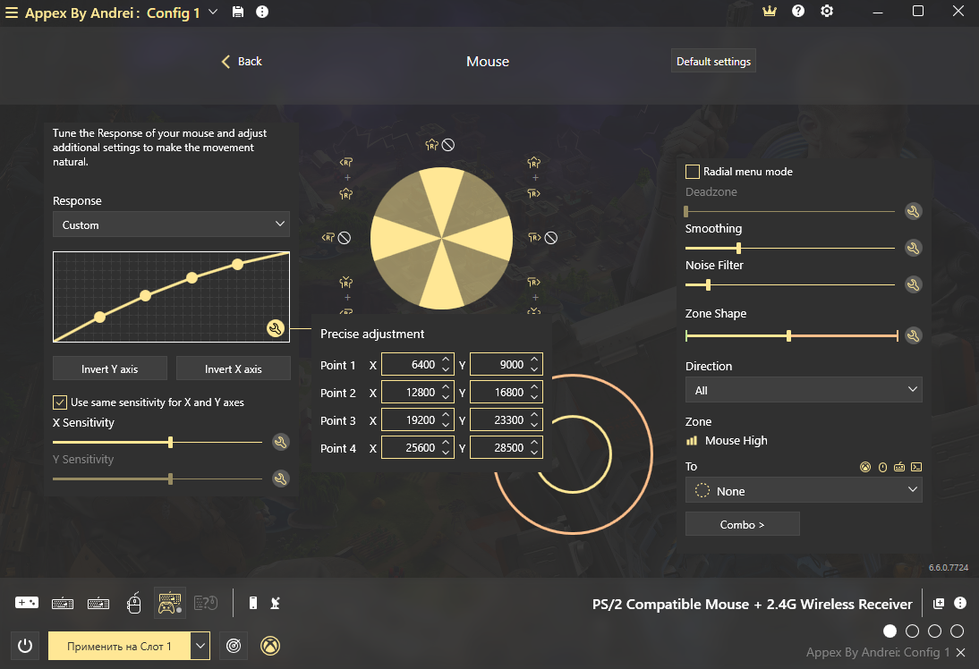

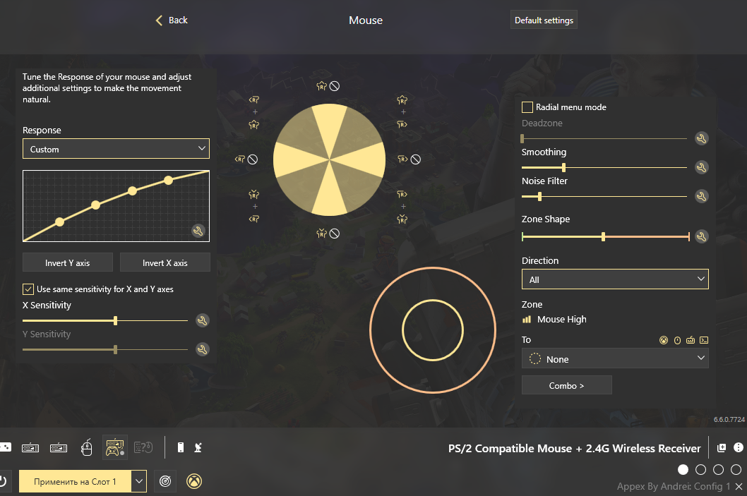

    My settings:
    In game:
    Look Sensitivity: 4
    Look Sensivity (ADS) 3
    Response Curve - Liner
    Look Deatzone - No
    Movement Deathzone - Lage​
    Rewasd:
    Unfortunately, none of our team plays Apex, and we cannot advise what settings would be better to set in the game. Also, please keep in mind that all zone, curve, and sensitivity settings are too individual; it is impossible to advise a preset that will suit everyone.
    Yes, in-game settings also affect how you control your character.
    A UDP server is used to transmit gyroscope data to emulators that support it, and it will not affect your game in any way when using a keyboard and mouse.
    In addition, we cannot advise what curve/deadzone settings you should set to improve your aim assist, since reWASD is not a cheat and does not provide aim assist; the game provides it for players using a controller; this also applies to our virtual controller.​
    In these articles, you can learn more about Advanced Mouse settings and Advanced Stick settings.
