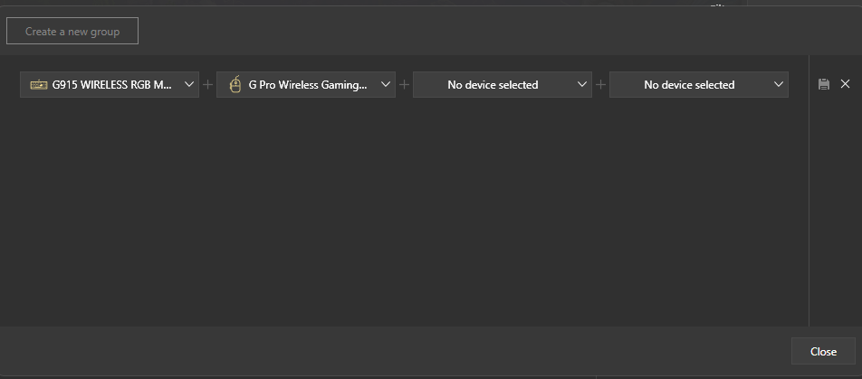

Hi, new here. I am trying to map a config and the mouse acts as a keyboard no matter what i tried. The icons show correctly yet the mouse either doesn’t move or it clicks and acts as a keyboard
Cant initialize mouse
The config itself does not seem to have any issues.
Please follow the instructions in case #24 here to resolve any issues related to initialization or grouping of devices.
If you are using a wireless mouse, you might need to use the [USB Receiver] device instead.

Have you used the [device detection mode] to check if the correct devices are added to the group? Make sure to disband the group before checking.
- Flag

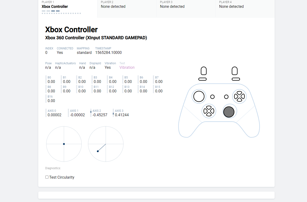

Please provide screenshots of the [Mouse] sub-config on every [Shift] layer of your config.
We also strongly suggest testing your config at the [Gamepad Tester] site.
- Flag
So with that, we have established that the game is the source of this issue. Please check if the in-game controls are set properly for the controller. For example: there might be an accessibility option that switches the sticks.
In case of incompatibility of the game with our virtual Xbox One controller, we suggest trying virtual Xbox 360 or DualShock 4.
