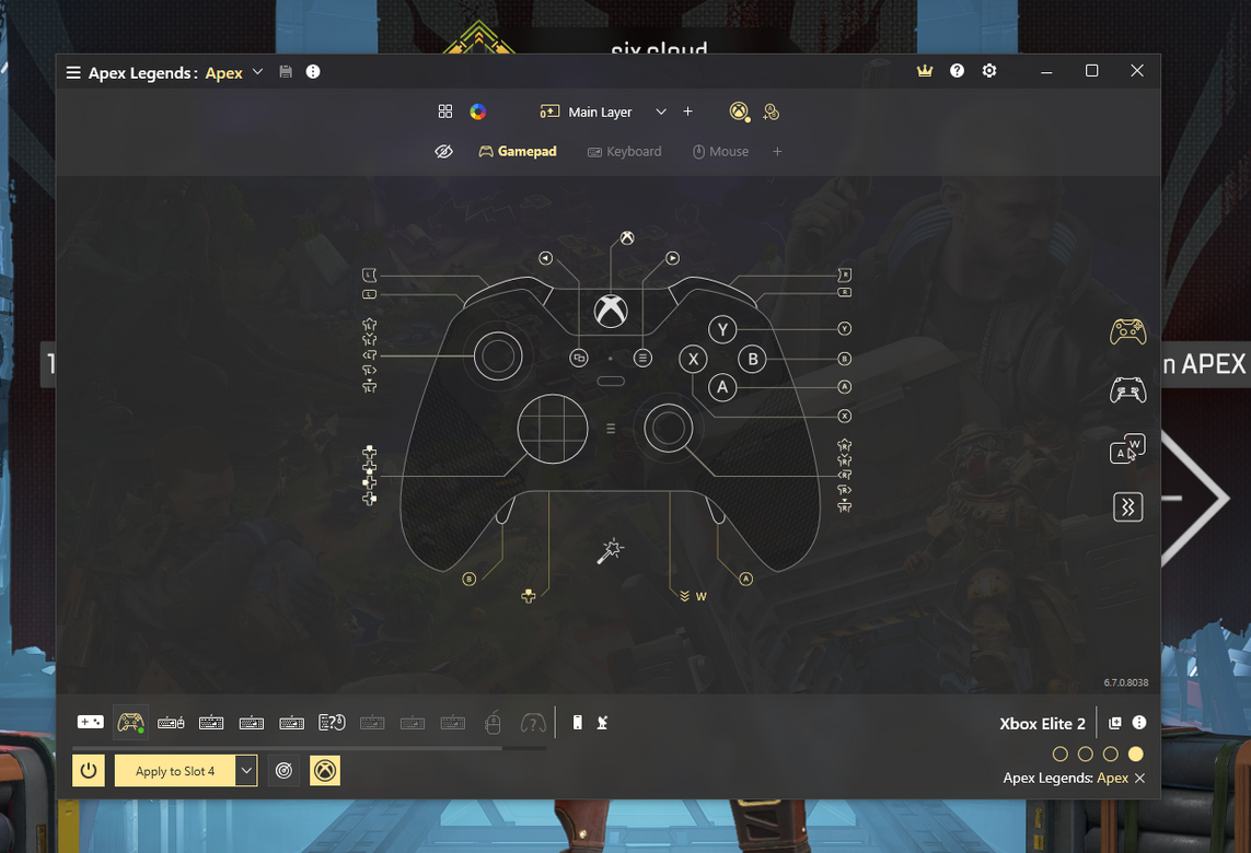

    I have been using ReWASD for months now without problem. Recently, one of the updates have appears to complete screwed ReWASD. Windows still recognizes the controller fine. Using the built in Windows utility, button presses are registered fine. While in game, using the big Xbox button works fine (brings up the overlay). The ReWASD macros I have assigned to my Elite 2 that use Keyboard inputs (for example, spamming the W key on the keyboard, assigned to Elite 2 paddle) works fine. Normal button presses do not. No button assigned to standard functions work at all.
    I have uncovered a fix. Open the ReWASD interface and press the power button to disable to ReWASD profile, then turn it back on. This fixes the issue.
    This is a massive annoyance and shouldn't be like this. It worked fine for months. Please resolve this immediately.
    Please take a screenshot of reWASD with your controller and the config you were using selected.
    We also need to know what the built-in Windows utility (joy.cpl) shows before and after you apply the config, and if your physical keyboard and mouse are selected at [Preferences > Input devices].
    We suggest using the [Apply to slot #] button instead of double-clicking the [Power] one, as [Power] only re-applies the previously applied config, and would ignore any changes made to the current one.

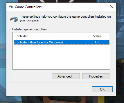

        Please send us 2 screenshots of how your controller is displayed in joy.cpl before and after applying the config.
        Also, try changing the virtual controller type and check if the problem persists.​

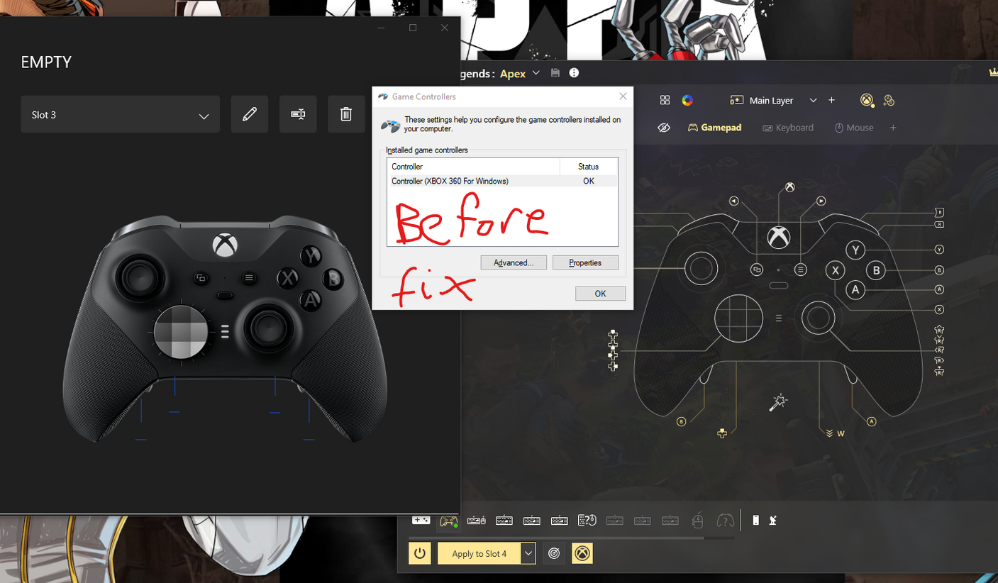

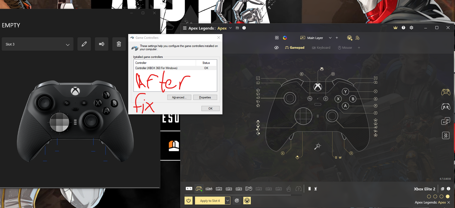

          Please see the attached images. They look identical. To obtain, I did the following:
          1. Reboot computer
          2. Run Apex Legends
          3. Attempt to use controller (doesn't work)
          4. Took Screenshot of joy.cpl + Xbox Accessories + ReWASD
          5. Used the POWER BUTTON on the bottom left of ReWASD to disable (and thereby return to native functionality)
          6. Waited 15 seconds

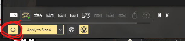

          7. Reenabled ReWASD using the POWER BUTTON (In case it isn't clear, I attached a screengrab of the power button)
          8. Controller works.
          This was not an issue before. This problem is new. I see others posting about this in your forums (namely someone complaining that Witcher 3 isn't being recognized) so it's unlikely an Apex specific issue.
            We still need a screenshot of [joy.cpl] tool when reWASD remapping is disabled.
            And we still suggest you change the virtual controller to Xbox One via the [Magic Wand] icon in the middle.

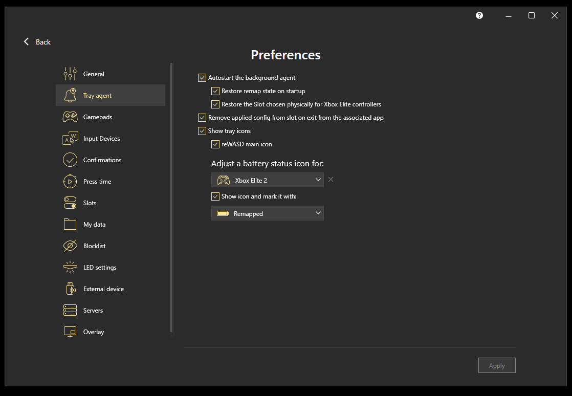

                Could you clarify if you have these three options enabled in [Preferences > Tray Agent]:
                • Autostart the background agent;
                • Restore remap state on startup;
                • Restore the Slot chosen physically for Xbox Elite controllers​.
                  ​I've been playing with ReWASD for months without needs to do anything extra, simply turn on the controller and I'm off to the races. I recently nuked my PC (fresh Windows installation) which required me to download the latest ReWASD. That is when my issues began. The game likely had nothing to do with it, as I played the game within the same day, thus the same patch.
