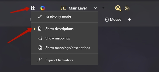

      Follow-up: Is there a setting that let's me add the Description of a mapping to be visible in its listing? Meaning I've assigned a default profile to the G13 in the base LGS mapping utility, and then added each of those to ReWASD in turn. I've given each a description in the mapping where it says "add a description" but I can't see that description unless I specifically click into an individual mapping. For a virtual keyboard like the G13, where all the keys are instead named G1-G22, it would be a lot more useful if ReWASD let me set custom list names so I could just look at the list to quickly check what my mapping is. I had hoped the "add a description" field would do that, but it doesn't seem so.
        If you have added custom descriptions for these keys, then you can change the mapping display type to Descriptions or Mappings/Descriptions.

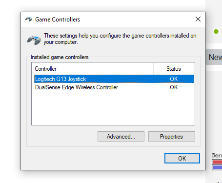

            Final question: the G13 has an option to set the thumbstick to function as an analog joystick. Windows sees it as "HID-compliant game controller" in the Devices and Printers window, wit ha hardware ID of "LogiDevice\\VID_046D&PID_C232," and every game I play usually detects it (and sometimes annoyingly so, if I'm wanting to use a different controller). I'm not able to see it in the devices at the bottom of ReWASD though. Interestingly, it does show a mouse-looking device called Logitech_LGVirHid02. with a VID/PID of 046D/PID_C231, just one off the stick.
            I checked the block list to see if maybe I had hidden it, but sadly the PID C232 device is not there. Is there a configuration I'm missing, or something else I can check to see if I can make it appear?
              reWASD would only allow this analog stick to be remapped if it was directly detected by the application as a controller. If joy.cpl does not detect this device as an Xbox One or Xbox 360 controller, but reWASD detects this device as a mouse or keyboard, then it is unlikely that it can be used with reWASD as a gamepad.
                  But that's the problem, as I mentioned before Windows does detect the joystick as a controller. It shows in the control panel, it is listed in the joy.cpl menu. See attachment.
                    The system detects it as a specific controller from Logitech, which we do not officially supported.
                    But there are many unsupported controllers that are detected in reWASD as Xbox One, Xbox 360 or Xbox Seriex S|X because they can work in X-input mode.
                    But unfortunately, this is not your case.​
