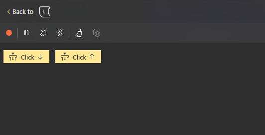

              1. Add a left stick click to Long Press activator, not by simple mapping, but through a combo.
              Then, when Long Press is triggered, the sprint button (the left stick click) will fire once, and then a second time when the button is released.

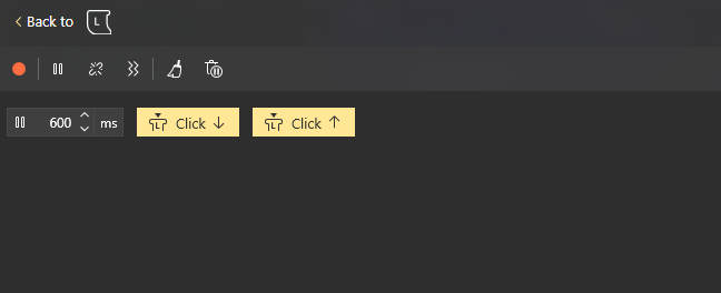

              2. Map Release Press activator in the form of a combo, adding a pause before clicking the left stick
              I’ll say right away that the first method works more correctly.​

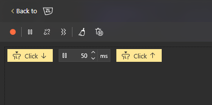

                Interesting, thank you for your help. This seems to work, but sometimes the long press doesn't seem to fire. Any idea why this may be or how to fix it?
                  Adding a pause between up and down seems to have fixed the issue with it not firing. For the time being this seems like a great solution, thank you for the help.
