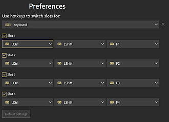

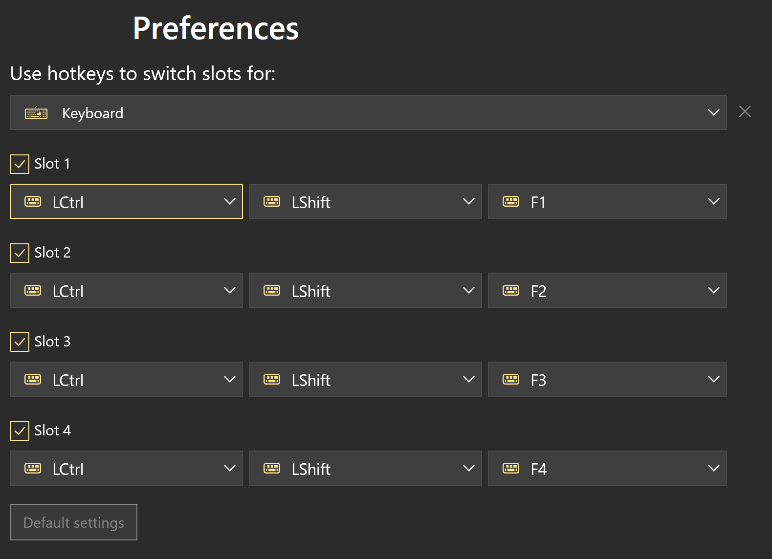

              Thank you! Since I am using only keyboard for this (I do not own a gamepad), when I go to the slot menu I see :
              Which I assume means I can use those hotkeys on keyboard to swap between slots anytime I want.
              Since I also will be running Voice Attack parallel to rewasd, this opens perhaps the possibility of using this slot swapping to reset the deflections. Simplest solution would be to have VA shift between 2 slots with a 120ms delay ... the purpose is just to reset all axis with one keybind anyway.

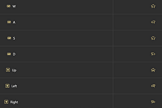

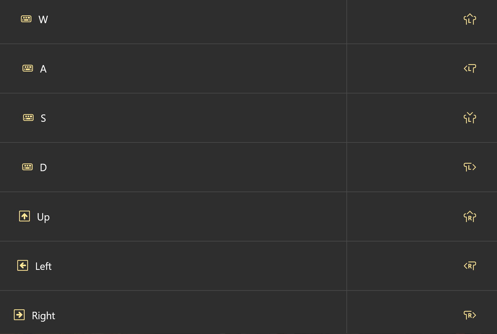

                    What I have done in ReWasd. This is done on Main Layer of keyboard only.
                    The 'down' arrow is set for Y axis Right Stick down. All inputs are set to Relative 20% deflection in their direction.
                    This is what is giving me the use of 4 axis in the game via keyboard. It works perfectly.
                    For this game, I have rotational control as pitch&yaw via arrow keys on keyboard assigned to gamepad's right stick. I then have strafe left/right and strafe up/down via WASD keys on keyboard assigned to gamepad's XY left stick.
                    For this game I do not need strafe forward/aft .. but I do need ROLL. That's the missing axis I need and I need it to be able to work as Relative 20% increment axis.
