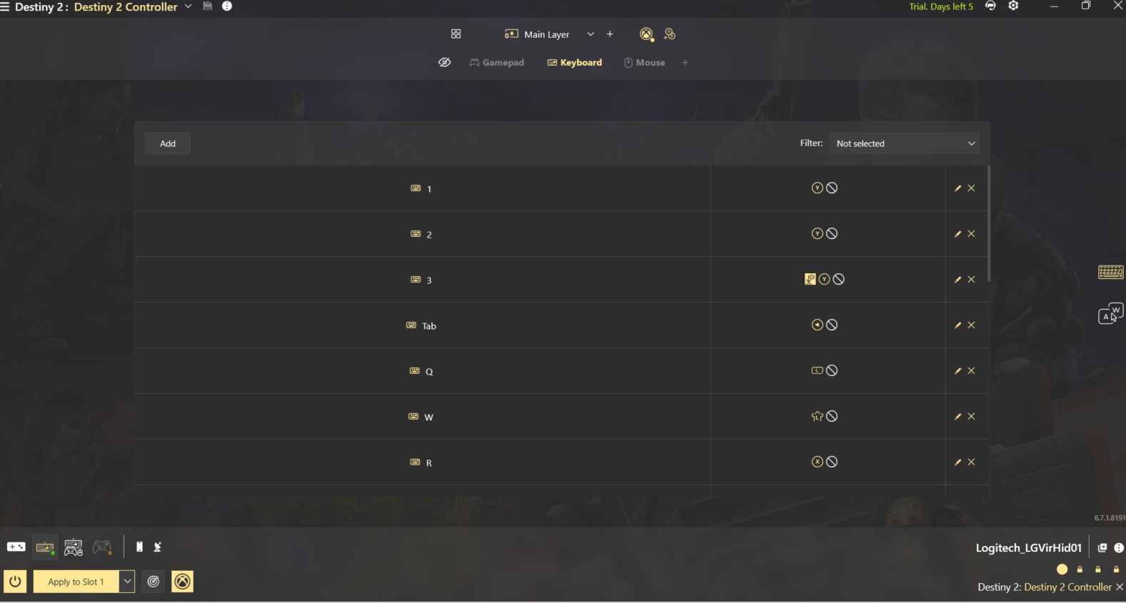

        First, you don't need to have a physical controller connected to a PC to use reWASD. reWASD creates a virtual controller itself.
        Our virtual controller appears in the tester after the system receives the input from the devices. So, you need to ensure that you apply the config to the correct devices. Also, there may be a chance that something is wrong with the device initialization. Please show me your group and how the devices are initialized there.
          I know - I just tested thge virtual as well to see if is working. I do preffer not to use the pysical one.
          Indeed - I used a existing config blindly, and not sure if I understand the ful picture. Mouse does not seem to be detected/correct (see my comments in the original post)
            Please note that LGVirhid01 is not your real keyboard. This virtual device was created by Logitech software. In turn, reWASD doesn't work with virtual devices. Feel free to add this device to a blocklist.
            Back to your idea, remaping KBM to our virtual controller. First, you need to initialize your devices correctly. You can use [Device detection] to know who is who if device names don't state that clearly. Then, group up your keyboard and mouse devices. In case of problems check case #24 here.
            Once the group of devices is created, you need to apply the config to this group exactly.

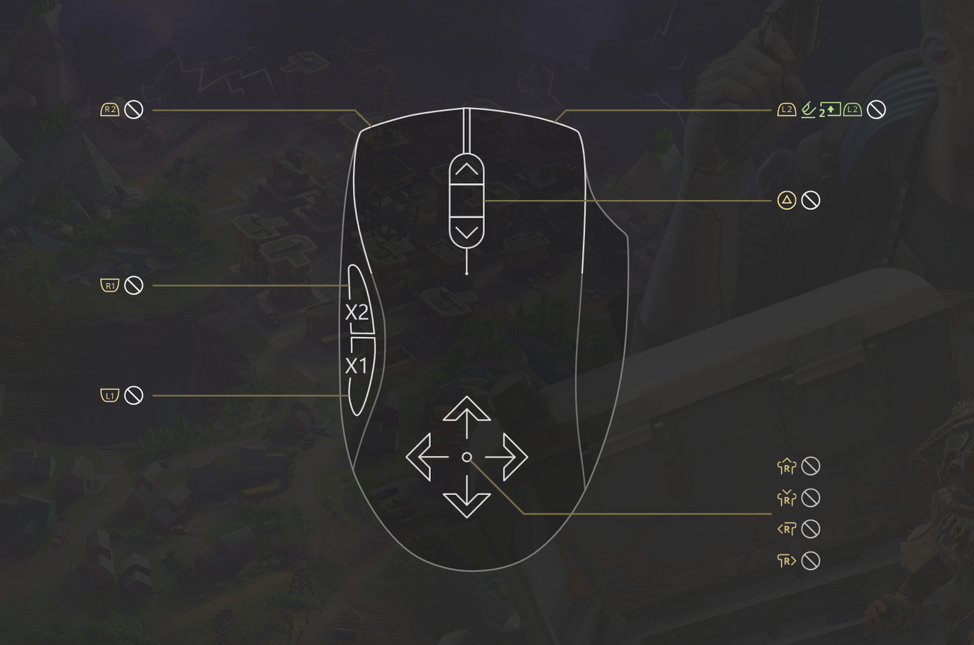

                    I do have some questions on a community profile I am testing.
                    1. Right cliek (Aim in Destiny) seems a combo ... anyone knows why ?
                    2. Mouse movement left/right/up/doown does not work - is this one of the advanced licence .. because it seems mapped ? Out of curiosity what is the specific of this ?
                    If is abbout the advanced feature ....Can I get the advanced features in the Trial version ?
                    If not possible and I buy them to see .. can I get a refund if this will not work ?
                      To emulate reWASD virtual right stick Advanced Mapping feature is required. Please note that each group of additional features in reWASD includes a 3-day trial period. So, you don't need to purchase a feature just to try it out.
                      Go to License tab and check if Advanced Mapping feature is activated.
                      According to the screenshot, the right click is adjusted as Jump to Shift. It is most likely that another shift has a different sensitivity or any other mappings there. This case is described in more detail here.

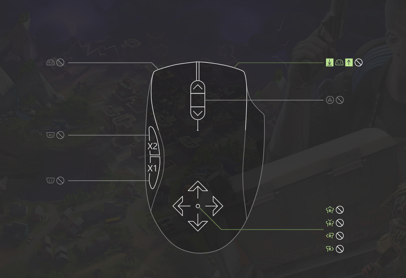

                              I retested a few profiles and most seem to work ok, however I still dont undestand why on Mouse RightClick (Aim Zoom in in Game), this goes on another Shift2.
                              I see there something that looks (for me) like not using the controller but the Mouse as standard.
                              Miron4ik42 as you replied to me ... below is Shift2.
                              Why would the creator want to give up the controller Aim Assist and move to a shift without it when AimZooming in ?
                              PS: I see this on a few profiles, so is not a mistake.
