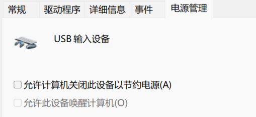

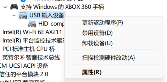

                    I run into this problem recently and turn out it should be a power saving management issue.
                    In Device Manager, you should find the "USB input device" under your "Xbox 360 controller for windows". Then uncheck the "Allow the computer to turn off this device to save power​" in power management setting. After that, the dongle don't loose responses anymore for me.
                    (Sorry for the Chinese screenshot, but it should get to the point.)

                      reWASD works with Flydigi in Android (DInput) mode, which has no Xbox 360 controller. So you show different case. But we tried to disable power management on DInput mode too, but unfortunately disconnects still happen. It seems to be some instability in the dongle firmware.
