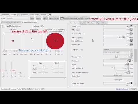

    I am using rewasd to convert KB&M to DS4.
    My perspective keeps drifting during the game even though I use it in KB&M
    I think this means there is a problem with reWASD's virtual controller.
    Stick drift occurs with Virtual DS4, Virtual DS3, and Virtual Switch Pro controllers.
    I found a message board for people who have the exact same problem as me. That's it here.
    ​https://www.reddit.com/r/rewasd/comm...s_this_normal/
    In-game settings: no dead zone, linear response curve
    When I measured the dead zone using DS4windows, the results were as shown in the video below.
    1: hardware sony ds4 2:reWASD visual controller
    I've also asked the same question on reddit.
    Due to physical wear, every physical controller will have a drift eventually.
    DS4 controllers always have a "drift" due to the low resolution of their sticks - 256^2 possible positions - which technically does not have an absolute center position.
    Our virtual controller uses value 128 (on a scale from 1 to 256) for every axis in an "untouched" state, resulting in negative values in Gamepad Tester, and probably the drift this topic is about.
    The only solution for the drift "issue" is to set the deadzone setting in the game to 0,79-1% value or use a virtual Xbox controller, which has higher sticks resolution.
    As for the second video about the "drift in the direction you tilt the stick" vs "always drift to the top left": am I right to assume that you wish reWASD to adjust the "center" point according to the last position of the stick? Like if it returned from the top left corner, the "center" value should be 129x128 (0.00392 x -0.00392)?
