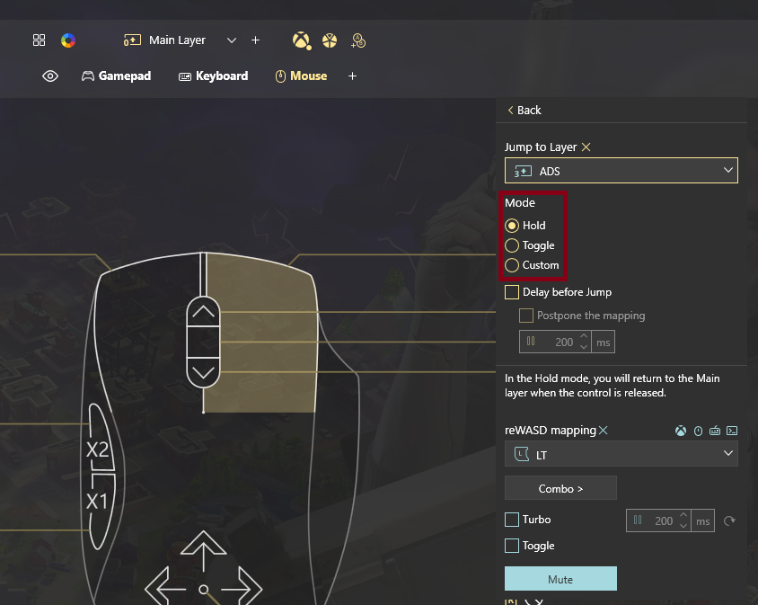

    Hello, I play wz. The game is in ads toggle mode. Can you give an example of an anti recoil command that is only active on right click? I know layer adjustments, but I can't do it. Sometimes anti recoil kicks in, sometimes it doesn't. This is annoying.
    I want an anti recoil that only works on right click. Thanks​
    I can suggest you check this config as an example of an anti-recoil combo that works only when you ADS.
    But if you want to use ADS in a toggle mode, then you need to change the shift layer swap to toggle instead of hold:
      Thanks for help. What I don't understand is, mode hold toggle custom. Do I need to select toggle from here?
        Exactly. You can find more info about shift layers here: https://help.rewasd.com/basic-functions/shift-mode.html
          Thank youuuuuu <3
            You`re welcome.
              Click image for larger version  Name:	image.png Views:	965 Size:	277.0 KB ID:	240429​
