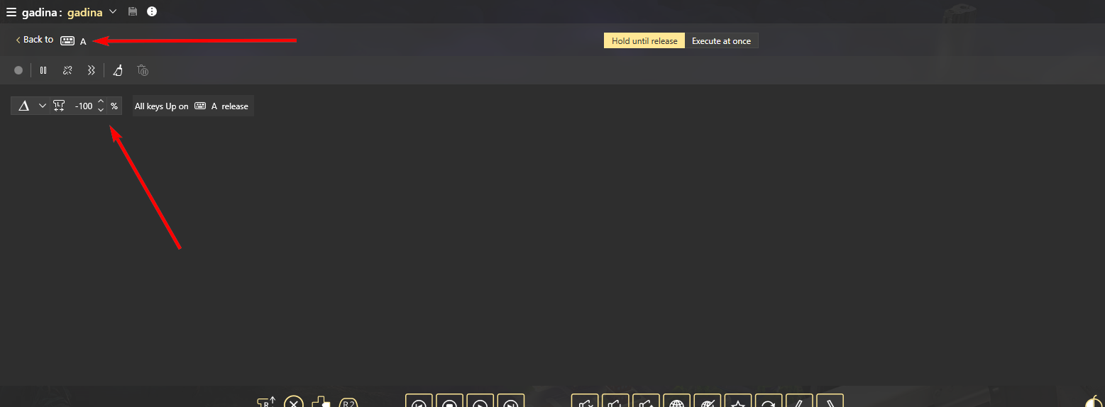

            I remapped A and D buttons using the combo editor instead of the common mappings
            As you can see, - 100 is the endpoint of the stick on the left. Please check if the game recognizes these mappings correctly.

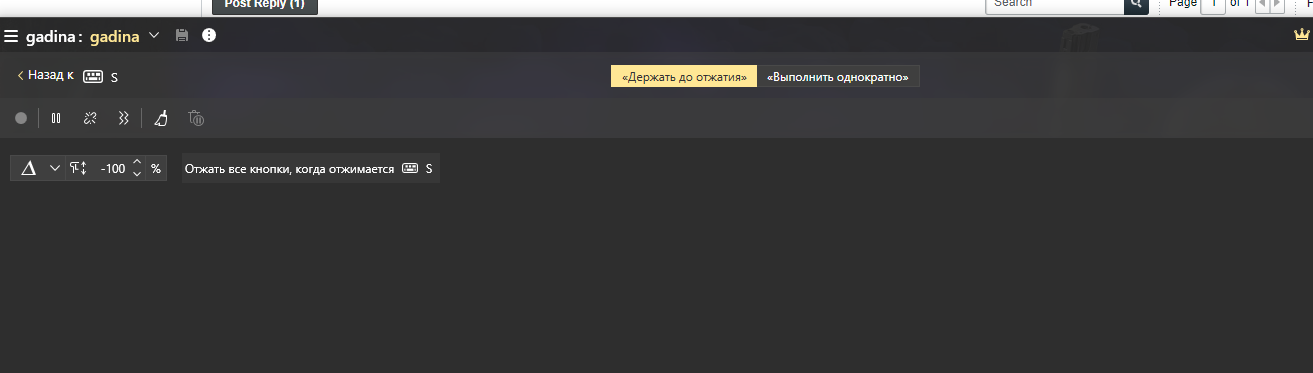

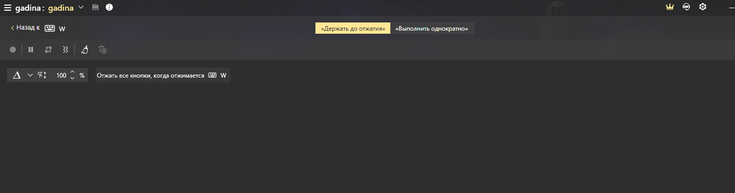

              Thanks a lot. I did the same for W and S as in the first screenshot and it seems now only dodges work as I wanted.
