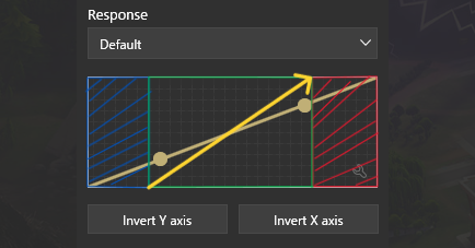

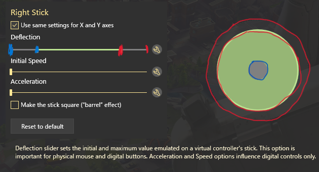

    What is the correct way to understand this setting?
    For example, in this case
Name:	スクリーンショット 2023-12-16 141504.png

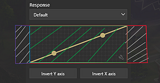

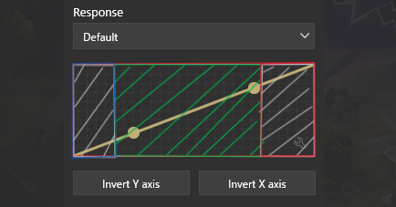

    Which is correct, A or B?
    A
    B

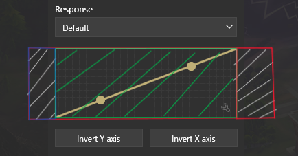

    [Deflection] values set the area of possible stick values the virtual controller will be using. The [Response graph], which is a mouse-speed-to-stick-deflection ratio, will be scaled to that area, so this interpretation is incorrect at its core.
    With [Deflection] values like on your screenshot and default [Response curve], any mouse movement will deflect the stick to at least ~20%, but will never go over ~80%.

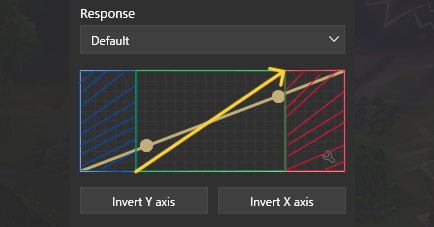

      Slope of response curve = speed at which the stick falls
Name:	スクリーンショット 2023-12-16 1416092.png
      The faster the stick tilts, the more sensitive the game will be.
      Is this also wrong?
      Sorry for not understanding
        The X-axis would be the mouse speed, and the Y-axis for the curve depends on how fast the movement should be emulated.
