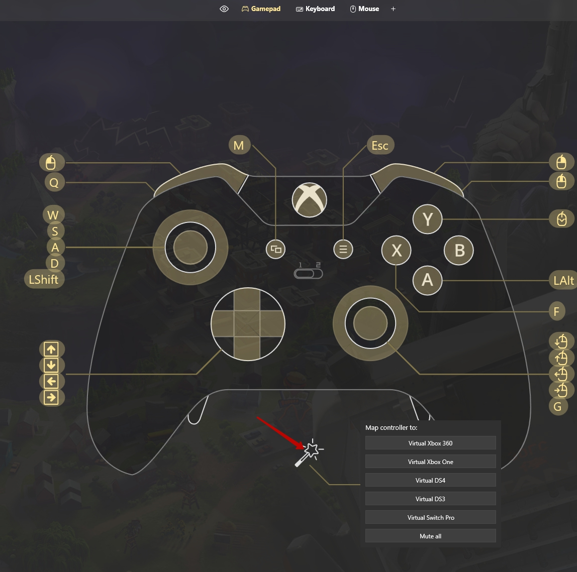

              1. Try playing games with native Xbox controller support. No reWASD remapping. Will such disconnects occur?
              2. If for FiveM you emulate a virtual keyboard and mouse on a physical controller, then try turning off the virtual gamepad emulation altogether by clicking on “Magic Wand” under the controller image.
