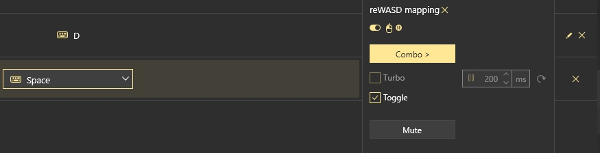

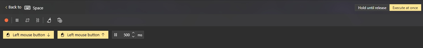

    This is what your combo should look like:

    Where is the pause after the mouse click, this is the frequency with which the mapping will constantly work.​
    Then simply enable Toggle for this mapping and apply the config using the "Apply to slot" button.
