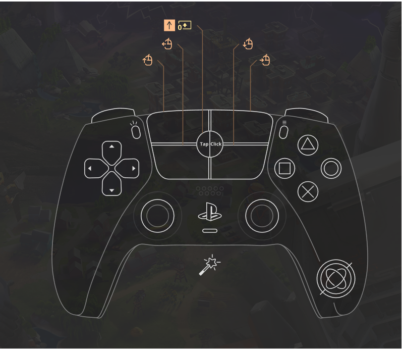

                  Although, there is one idea that might be useful to you.
                  Try to add to the Tap Jump to Layer mapping with the delay before Jump. Then, in this Layer, add the mouse to the touchpad.
ID:	241819Click image for larger version
                  As a result, the mouse mapping will appear after a tap​
