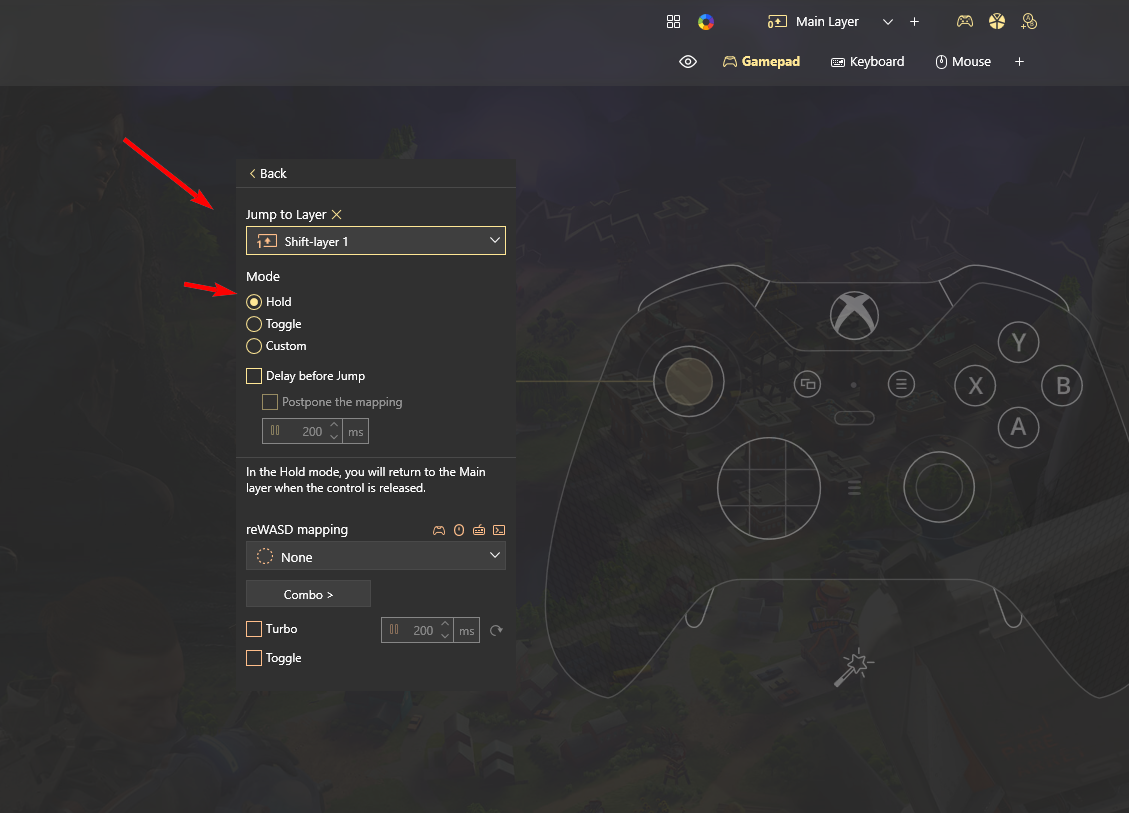

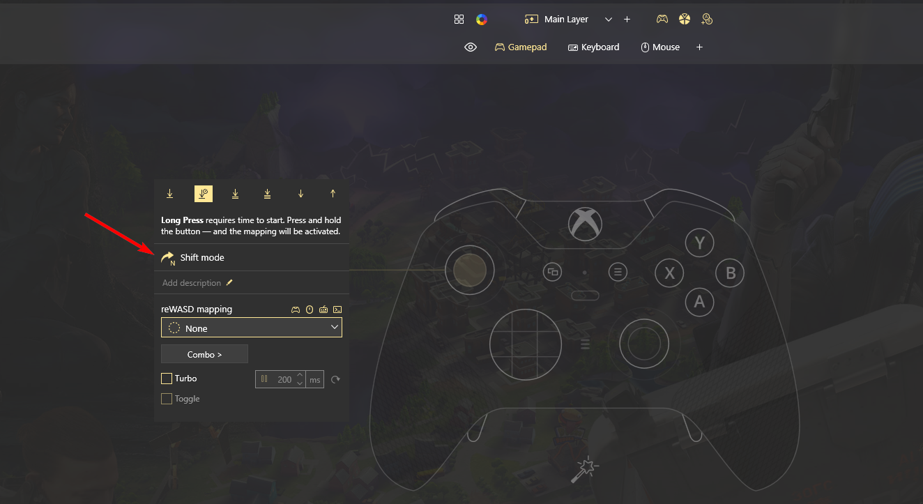

    All you need to do is choose Long press activator and add Jump to Shift mapping
    So, while you will hold the left stick button, you will go to a certain layer. Once you release the button, the Layer will come back​​
