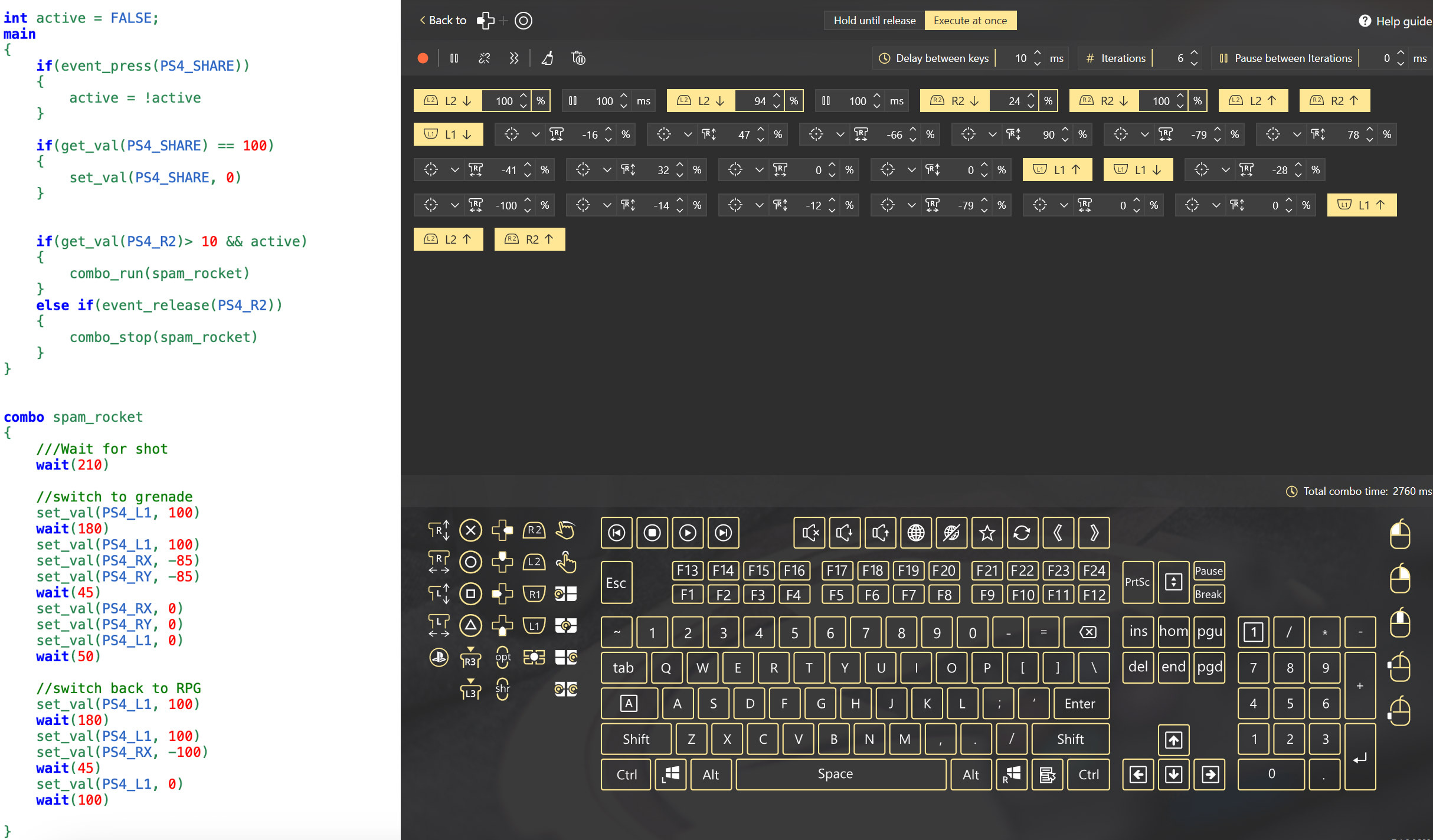

ID:	242101 Hi, I'm trying to recreate this simple macro script (left pic) via combo (right pic) (I'm using a dualsense controller). I approximately succeeded (although Rewasd recorded too many steps). What bothers me though is that when I run this combo I can't use R3 (right stick) to move around (if I do the combo fails). I did something wrong?

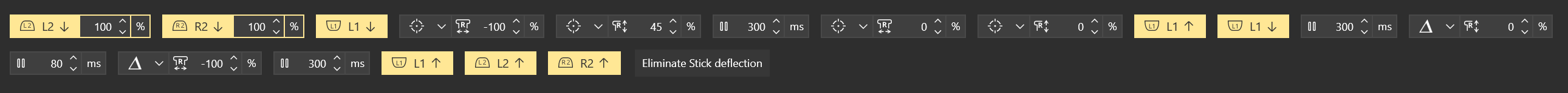

      Hello. Putting my right stick to relative stick deflection didn't work. The combo stops running correctly and the camera is spinning around like crazy.
        Send the config you use, please
          Hi, here it is. R3 (right stick has to pulled up till 10am (45°) and released, then go back down to 9am (-45°) and released.

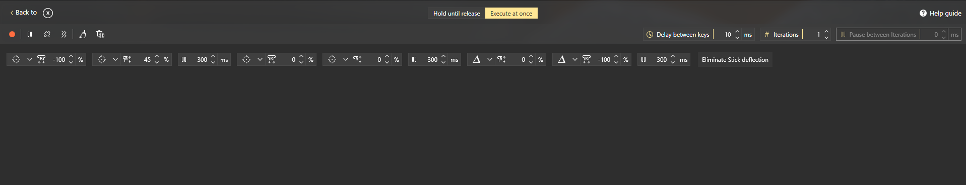

            You can try to add this kind of combo for the right stick.
            I checked how the combo works in the gamepad tester and everything looks fine, I guess. ​
