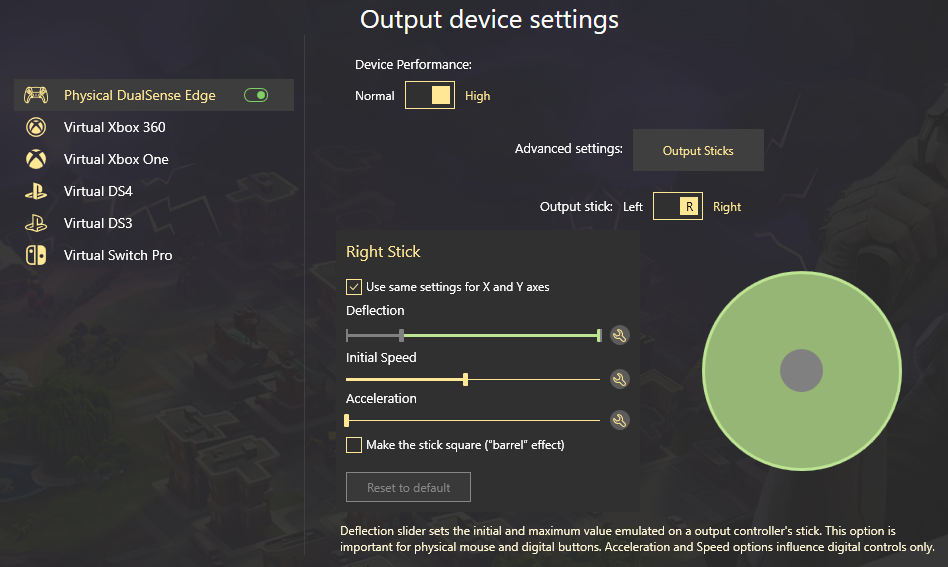

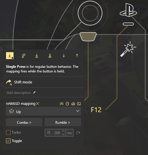

    I tried to set up an auto-run button in both Dragons Dogma 2 and Enshrouded by assigning a button with the toggle function to permanently push the left stick forward.
    And it kinda works.
    But unfortunately the autostart always stops after a certain time.
    Sometimes I have to press the button several times for the autostart to start at all. Then there are also phases in which it starts immediately, but then stops again after a short time.
    This is what my (simple) setup looks like:
    Controller is a DualSense Edge. Tried it in Physical- and Virtual-Mode.
    I also tried assigning it to the thumbpad, but it doesn't work there either.
    Any advice would be greatly appreciated! ​

        Your toggle mapping looks correct. However, I see that in addition to virtual controller mappings, you have virtual keyboard mappings.
        This means that in-game controller and kb&m input can switch, which can cause lag.
        I would recommend checking whether toggle works properly in this tester.​
