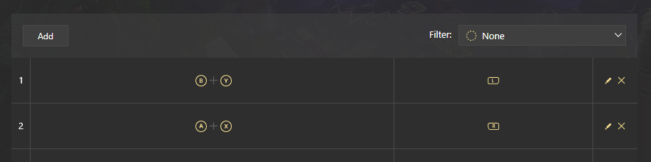

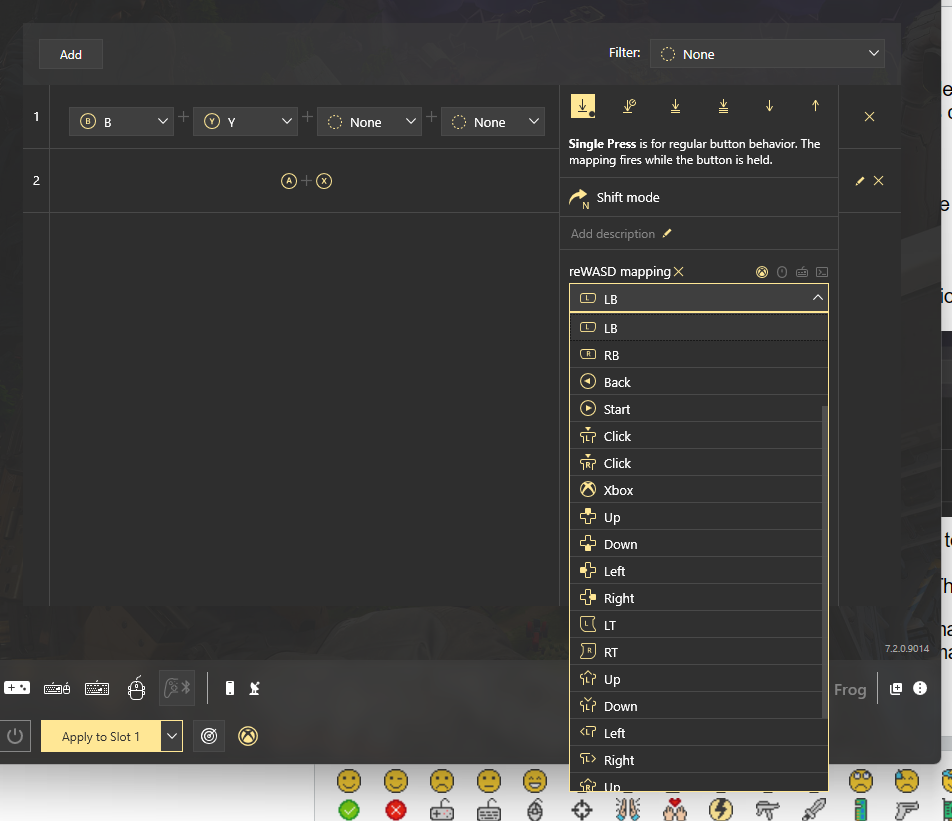

      This is how I've worked around the issue.
      But first, an important disclaimer... this workaround is definitely possible with the controller I'm using (this one), but I can't guarantee that it will work with any of the controllers you're interested in. And if you decide to buy the controller I'm using, be advised that it has click triggers (not like what you'd find on a DualShock or Xbox controller).
      Here's what I've done:
      My controller has two customizable buttons--M1 and M2. These can be remapped either to a single button click or a sequence of button clicks.
      With a little fiddling, I managed to assign M1 to B+Y, and M2 to A+X
      Next, inside reWASD I created mappings for what those key combinations should produce.
      #1 - Key combinations triggered by M1 and M2 remapped to LB and RB
      Screenshot #1 - Key combinations triggered by M1 and M2 remapped to Left Bumper and Right Bumper
      Once that is set up, I can change the remappings to anything I want. The screenshot above is showing that:
      • when I press M1, my controller produces B+Y, but reWASD remaps that to Left Bumper.
      • when I press M2, my controller produces A+X, but reWASD remaps that to Right Bumper.
      ​But I can remap that to anything I want, including controller, mouse, and keyboard mappings, any other mapping available in reWASD, as well as combo sequences.

      Here's one important caveat. It took some fiddling around to get my controller to recognize the button combo as being pressed simultaneously, and that the combo should remain pressed for as long as I'm pressing the corresponding M button. This is mainly due to the fact that my controller doesn't have any associated software. I'm guessing that the controllers you're interested have proprietary software that would make this process infinitely easier. If you can't find specifics online, I'm sure you could get clarification from their community (or maybe someone here can confirm from personal experience).
