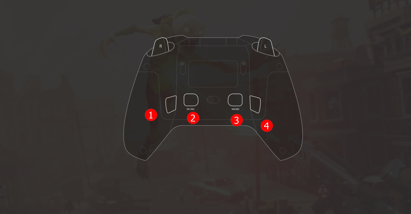

    Flidigi Vader 3 Pro is fully supported in reWASD. So, all 4 back buttons are available to remap in reWASD.
    You are right; due to the hardware specifics, Flydigi gamepads have a two-dimensional gyro. Because of that, there are some restrictions regarding the way gyroscope works on Flydigi controllers:
    • remap gyroscope in Gyro mode only
    • you cannot add Lean mappings
    • you can't Calibrate gyro
    • Swap gyro axis command is not available for these controllers
    Unfortunately, there are no gamepads with available back buttons for remapping other than these controllers you already mentioned in your post
        Does that include wireless connection for the Vader 3 Pro?
        I would love to map the additional buttons, but no matter what mode I use to connect it over bluetooth or the dongle, it either just shows up as Xbox controller, Nintendo Switch Pro or as unsupported device.​
          Hi Martoffel
          Please make sure you are using the official adapter and that your controller is in D-input mode.
            Got it, thank you!
