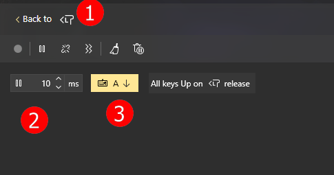

    Back to the bug. The "Re-press the held button when switching the Shift layer" option has no effect on the stick as this option was designed only for a digital key, so the disabling/enabling makes no difference. However, the bug you describe does occur. This is a known issue, but there is currently no ETA on fixing it.
    As a workaround, I would like to suggest adding a small pause before each directional mapping, so that the game has enough time to detect it, and so, for example, the character doesn't stop once you go to Shift or return to Main
    I hope this helps you in some way​

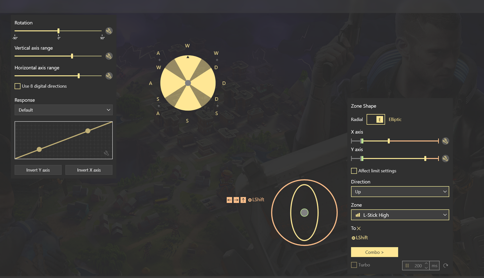

      Unfortunately the workaround does not work for me because I'm using `Shift` in Up `L-Stick High` Zone for auto sprint which is a killer feature for me that distinguishes REWASD from Azeron software. So every time I change/leave a layer while sprinting I observe the following sequence `WWWWWWWWWWWWWWwWWWWWWWWWWwWWWWWWWWW`, the character in the game stop sprinting for 1.5 seconds.
      Click image for larger version  Name:	image.png Views:	2 Size:	1.11 MB ID:	242584​
