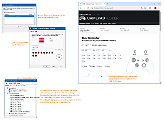

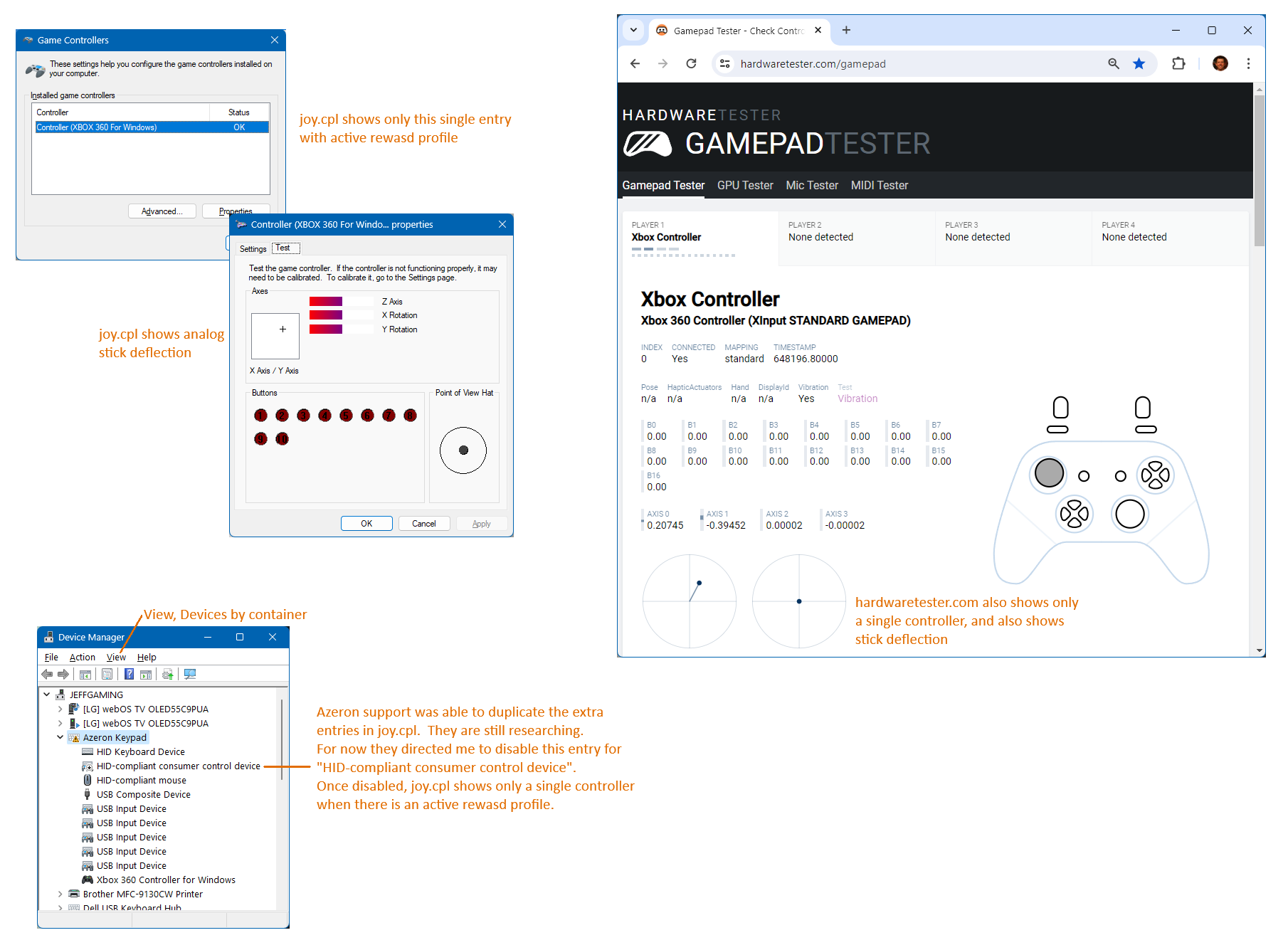

            I spent some time with Azeron support, see this thread, https://forum.azeron.eu/index.php?th...ectinput.1911/
            They were eventually able to duplicate the unexpected multiple entries in joy.cpl. They are still researching. For now they gave me a workaround to disable an entry for "HID-compliant consumer control device". With this disabled, joy.cpl now shows only a single controller when there is an active rewasd profile. The properties in joy.cpl show analog stick deflection (as expected), and also hardwaretester.com shows single controller with analog stick deflection. See attached screenshot.
            And yet, Talos Principle 2 (TP2) acts like there is no controller plugged in.
            Using Azeron's own basic mapping software, Talos Principle 2 does see a controller.
            I'd love to be able to use rewasd with TP2 because rewasd has much more flexibility than Azeron's mapping software.
            Does the rewasd team have other things for me to try at this point?
