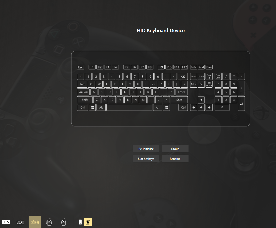

    Basically when i try to use rewasd with shadow and i go to detect devices mouse is seen as keyboard or vice versa its both 1 active device so if i go to detect device press on mouse its same as with keyboard need help tryed on discord support they said cant help idk what to do this is only way i can use rewasd on my pc i cant only shadow cloud

        I cant record but basically this when going detect devices this flashing thing its the same for my mouse and keyboard its this same device Click image for larger version

          In device manager i also have HID Compliant mouse which is not being detected only a device named "PS/2 Compatible mouse" something like that
            Are you using a laptop? Laptops usually have the keyboard and touchpad identified as the same device. If you don't need a touchpad, initialize the device as a keyboard. Otherwise, initialize the device as a mouse and remap the keyboard keys via the additional mouse buttons menu (second icon at the right side of the app).
