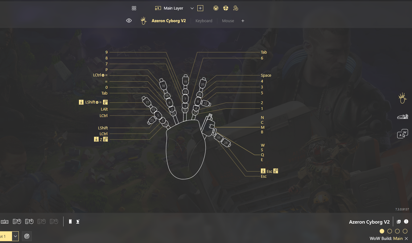

            I just tried setting and using that additional thumb key and it's not activating on my WoW client. The old 11 key works fine but not the 28, which is the new thumb input.
              Show us your config and check if the system exactly sees the reWASD input.
                Is this what you mean by config?
                  Yes, it is.
                  Perhaps you have already checked, but I’ll still ask: Does this key work outside of WoW or when you remap it through the Azeron software instead of reWASD?
                    So the 28 key is activated and is triggered on the Azeron software. The moment I close Azeron and open Rewasd, it doesn't work on WoW. That's the reason I made both of them the 'ESC' key. Just in case it gets triggered. So far nothing. I'll try again once I log into WoW when it's live.

                        Have you tested the mapping of "Esc" on the "28" key in any online keyboard tester (not in the game)?
                          That key doesn't work in any other games I've tried however it's registered on the Azeron software.
                            Please send a video of you using the reWASD config and testing the "Esc" button mapping in some keyboard tester.
                              Here's a link., Hope that helps. https://imgur.com/tn5oXAO
