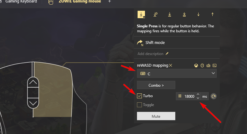

      Hi. PC Keyboard C down | C up ⇾ in loop every 18 seconds as long as RMB is pressed
        You can use Turbo to achieve this

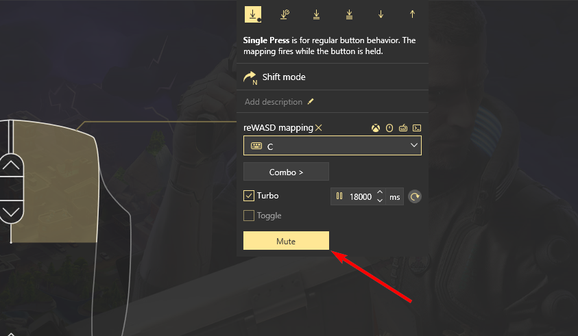

          The only problem is that the right mouse button also fires when holding down
            Use Mute option to hide the native input of RMB

              Sry but can't edit. C isn't running in a Loop.
              Ok.. So, ill keep Mouse Button pressed which is firing all time and with it, I want C to run in an 18-Second loop (press, release, wait 18 seconds, loop)

                If you want to hold RMB physically, get RMB input constantly and at the same time have C pressed every 18 seconds, then Miron4ik42 gave you the right recommendation with mapping via turbo on RMB without Mute.
                When testing the mapping in any keyboard tester or text editor, C is triggered every 18 seconds while you hold RMB.​​
