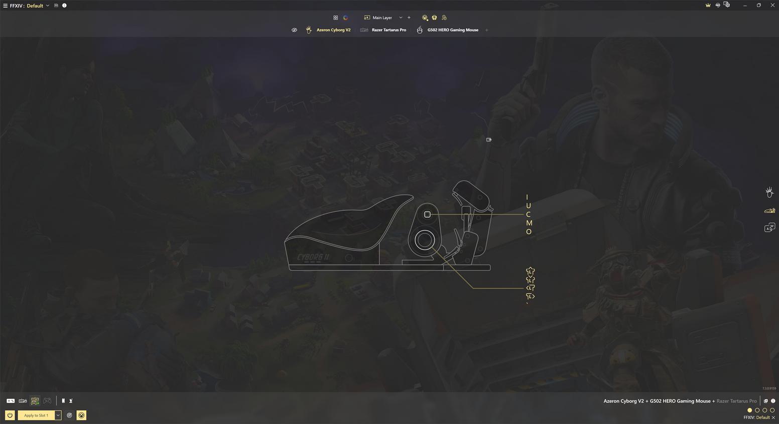

    Could you send a screenshot of the full reWASD window with your config on it?
      Please let me know if you need anything else.
Name:	Screenshot 2024-08-09 173149.png
        If everything works in the tester and joy.cpl, then on the reWASD side the emulation is performed correctly.
        In the screenshot I see that the analog stick is remapped not to WASD but to the left stick of the virtual Xbox 360.
        1. The game may not be able to handle 2 types of input at the same time (kb&m and controller) and you need to remap all the buttons used in the device group either to Windows input (kb&m) or to the virtual controller input.
        2. Close the game, turn off the remap. Try changing the virtual controller type on Xbox One and start the game again.
        If it does not help, do the same steps using the virtual DS4.​
