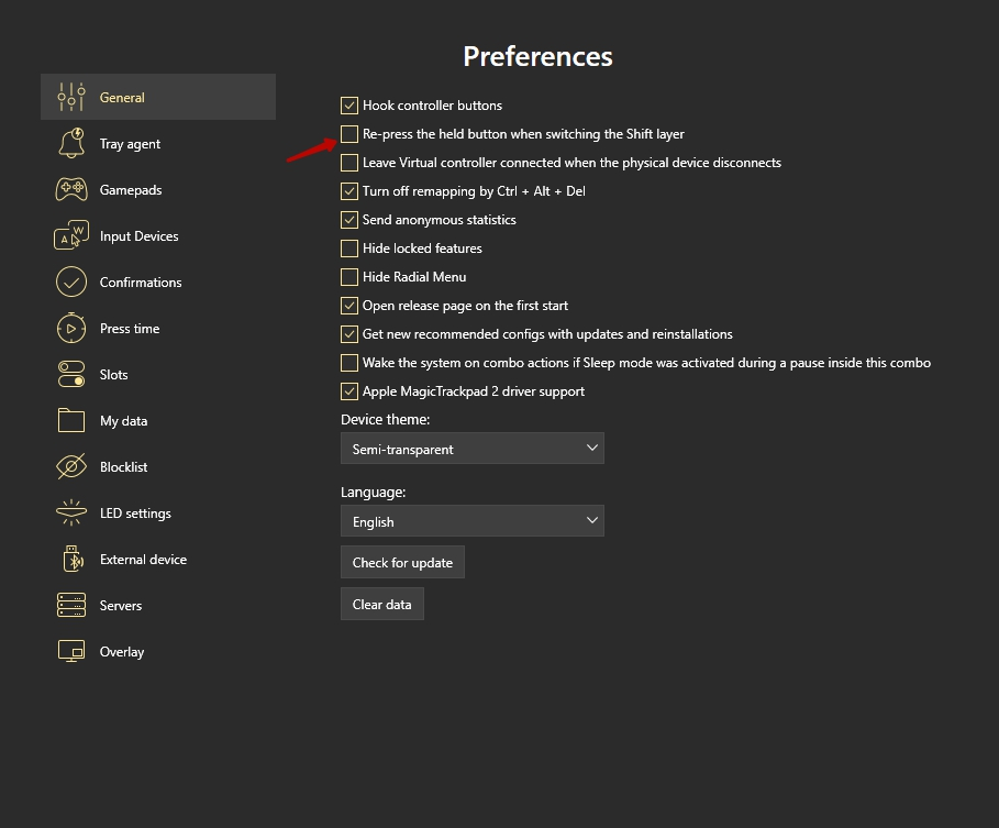

        Thanks for the detailed explanation. Do you have this option enabled?
        If yes, try disabling it and apply the changes.​
