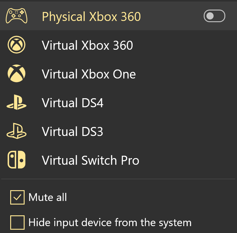

                    The video shows you triggering system shortcuts, such as changing the keyboard language layout or the screen resolution.
                    It might be because your controller is not muted. Open the [Magic Wand] menu and enable the [Mute all] option.

                        So, I did that and while I don't get the black screen from Esc key binding, I do get the keyboard shortcut still popping up. I have attached a screenshot from the Magic Wand menu to make sure I have selected everything I need to. As I am unsure if I need to have any of the other options selected.

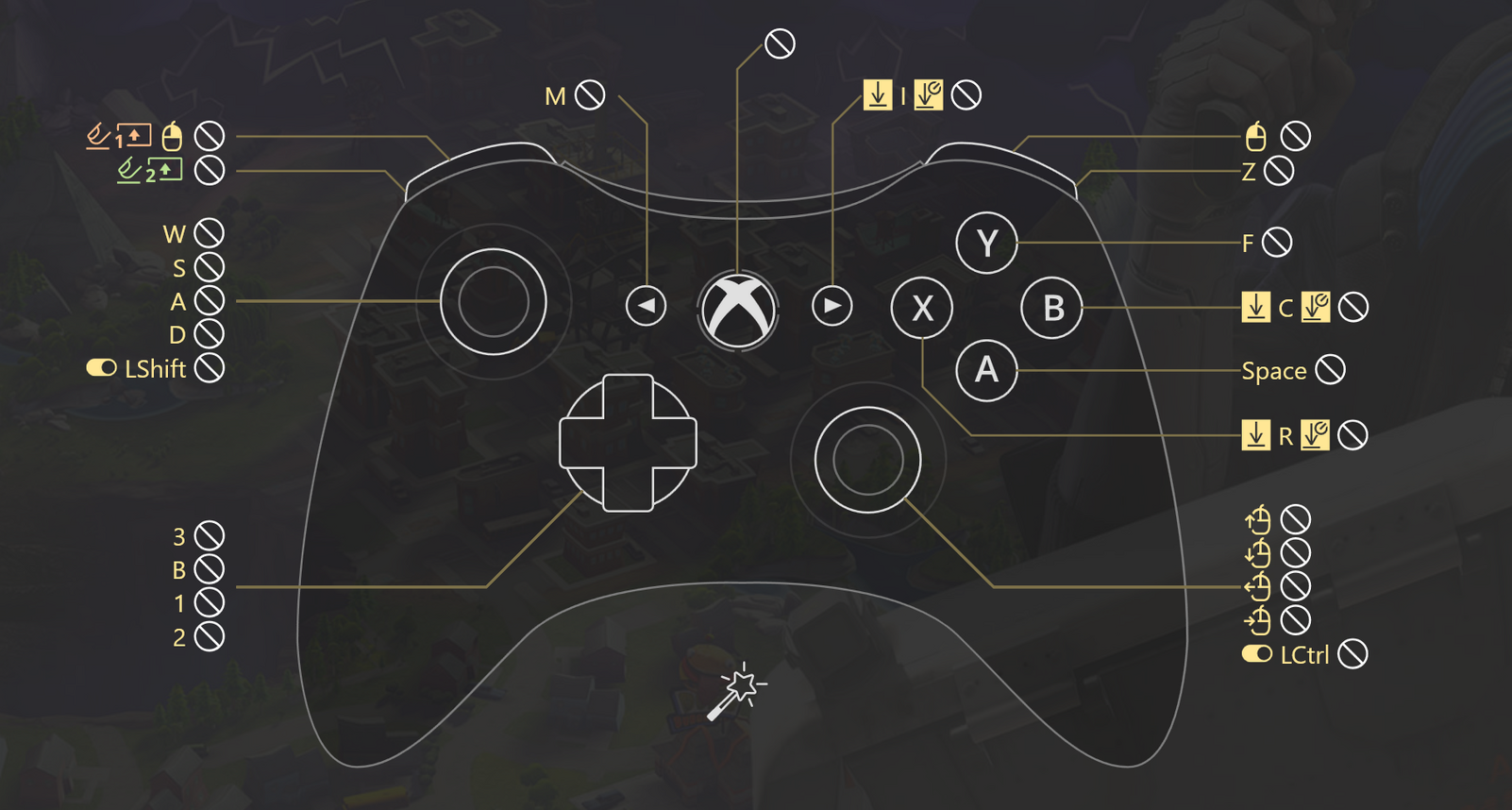

                        Plus I have attached an image of my layout to make sure it is all correct.

                          Your layout has [Shift] and [CTRL] on [Toggle]. Those keys are known to be involved with language layout change shortcuts (e.g., CTRL+SHIFT, CTRL+SHIFT+number, ALT+SHIFT). Either change the shortcuts used to change the language in Windows or use other keys in your config.
                            The only reason I have them on toggle is there is no toggle option within the game. So for running I would have to hold down the Left Stick to run everywhere, rather than click it(toggle).
                            Okay, I have turned off the shortcuts completely in Windows. So hopefully that will resolve the issue.
