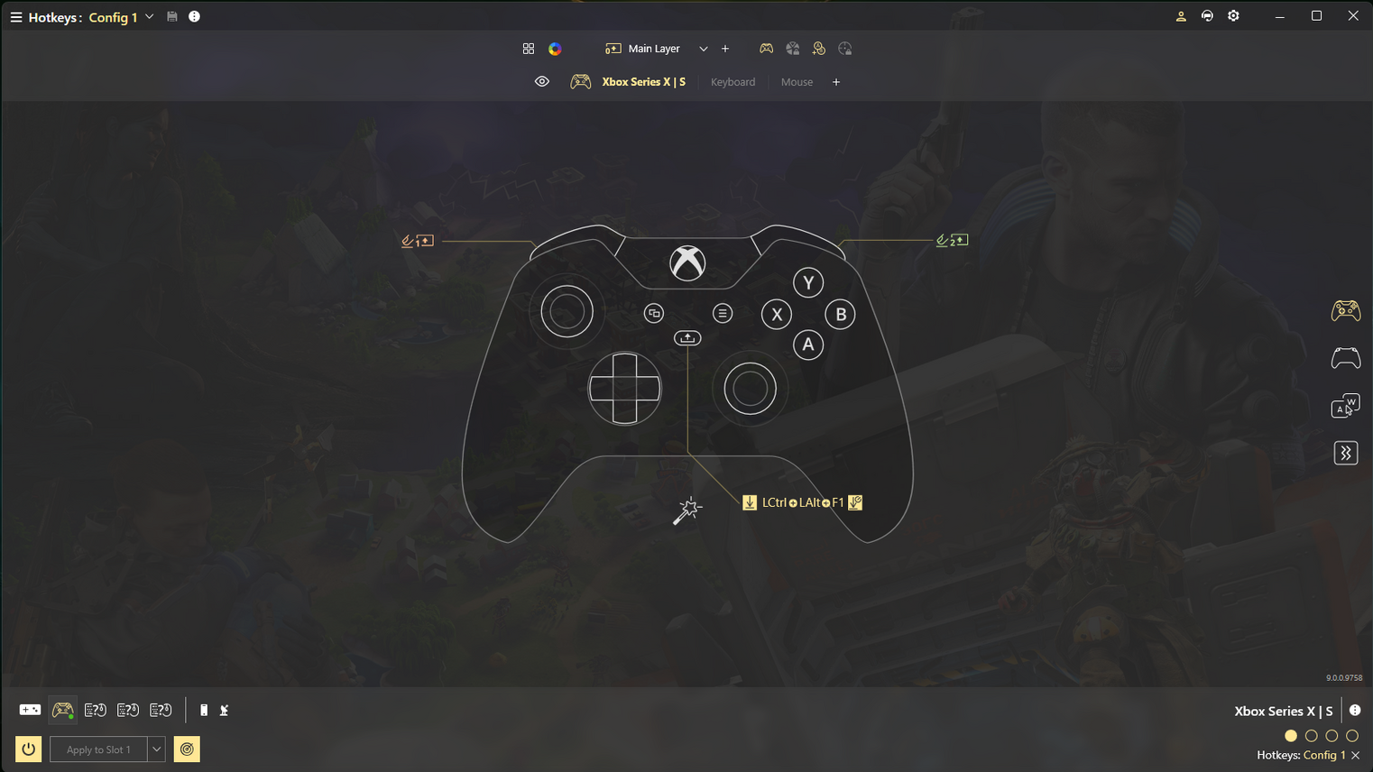

              Sure. Here's with the xbox controller connected with wireless adapter. This works as intended:
Name:	Screenshot 2025-02-16 103218.png

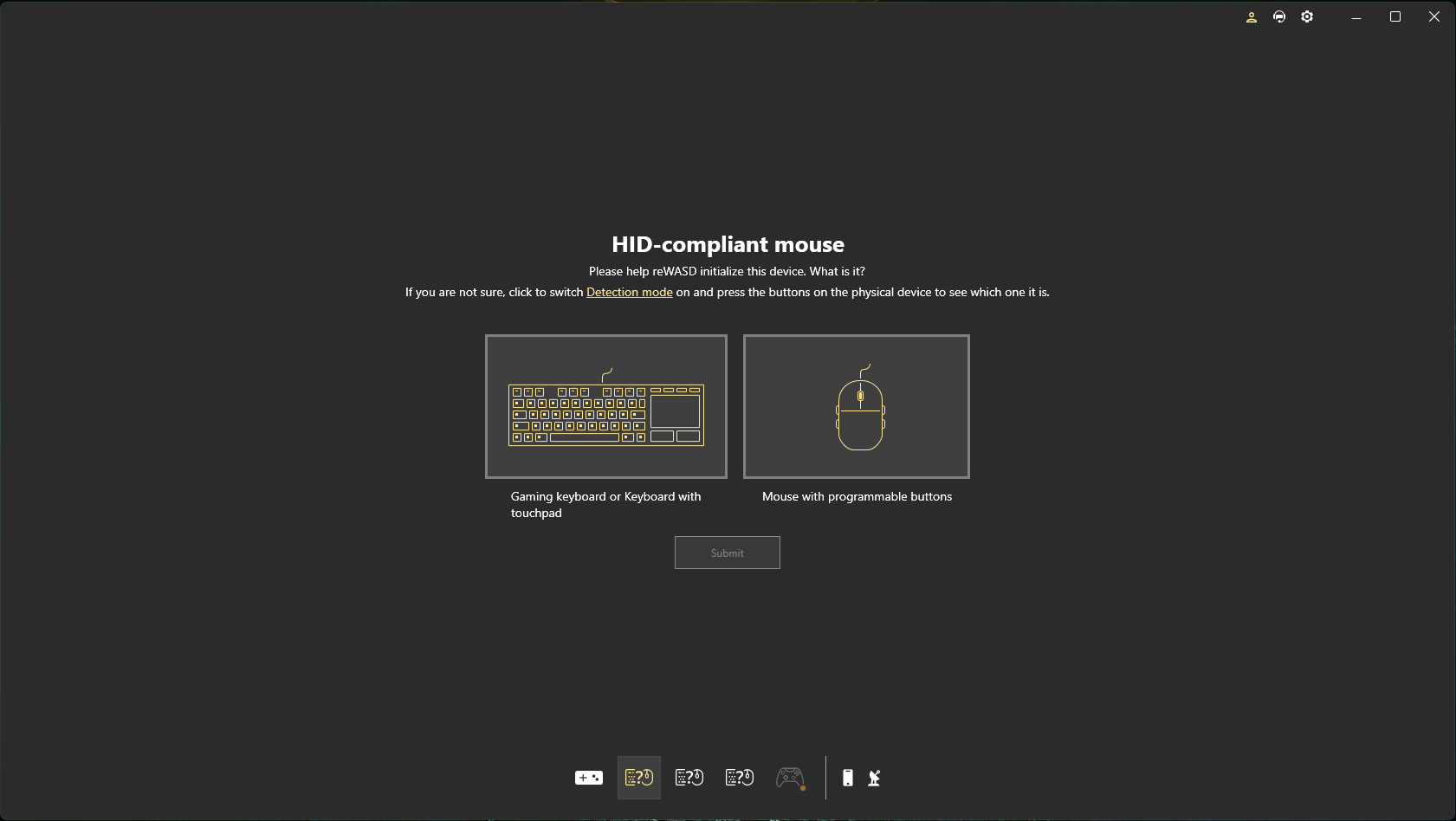

              Here's with the adapter controller disconnected and the Bluetooth controller connected. It just doesn't recognize it at all:
Name:	Screenshot 2025-02-16 103254.png

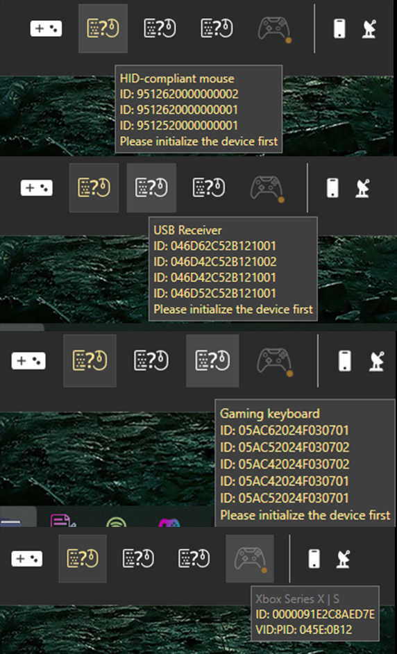

              And here are some screens of more details of the listed devices at the bottom if that helps:

                Please collect the Service / Driver logs of how the device connects to the system as described in this guide.
                Once you have gathered the logs, please send them to me via private messages so we can analyze the issue further.
