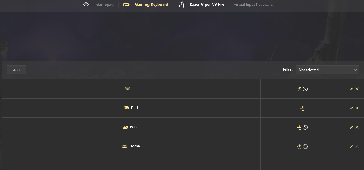

    I’m trying to set mouse movement to my keyboard keys, the keys am using are up-Ins(key) down-End(key) leftHome(key) right-Pgup(key). And when a apply it just doesn’t work. But if a change those keys with any of the alphabet keys it works flawlessly. So the keys i used the first time don’t work as key inputs?

    In my case it is configured like this and works correctly.

    Please send me your config, in which the mappings are set up correctly but do not work.
    I need the correspondent *.rewasd file.​
