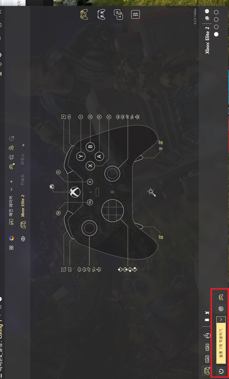

I'm using the ElitePad 2, and it connects just fine. It works too! But the remapping button won't press. The red square area does press, but it doesn't activate.
The remapping button does not press.

reWASD is unable to start the [rewasdcompiler] component due to the "Access denied" error.
This suggests that your current Windows account doesn't have sufficient access rights for the file.
Close reWASD and its Tray Agent, then restart the app as Administrator to check if that fixes the issue.
