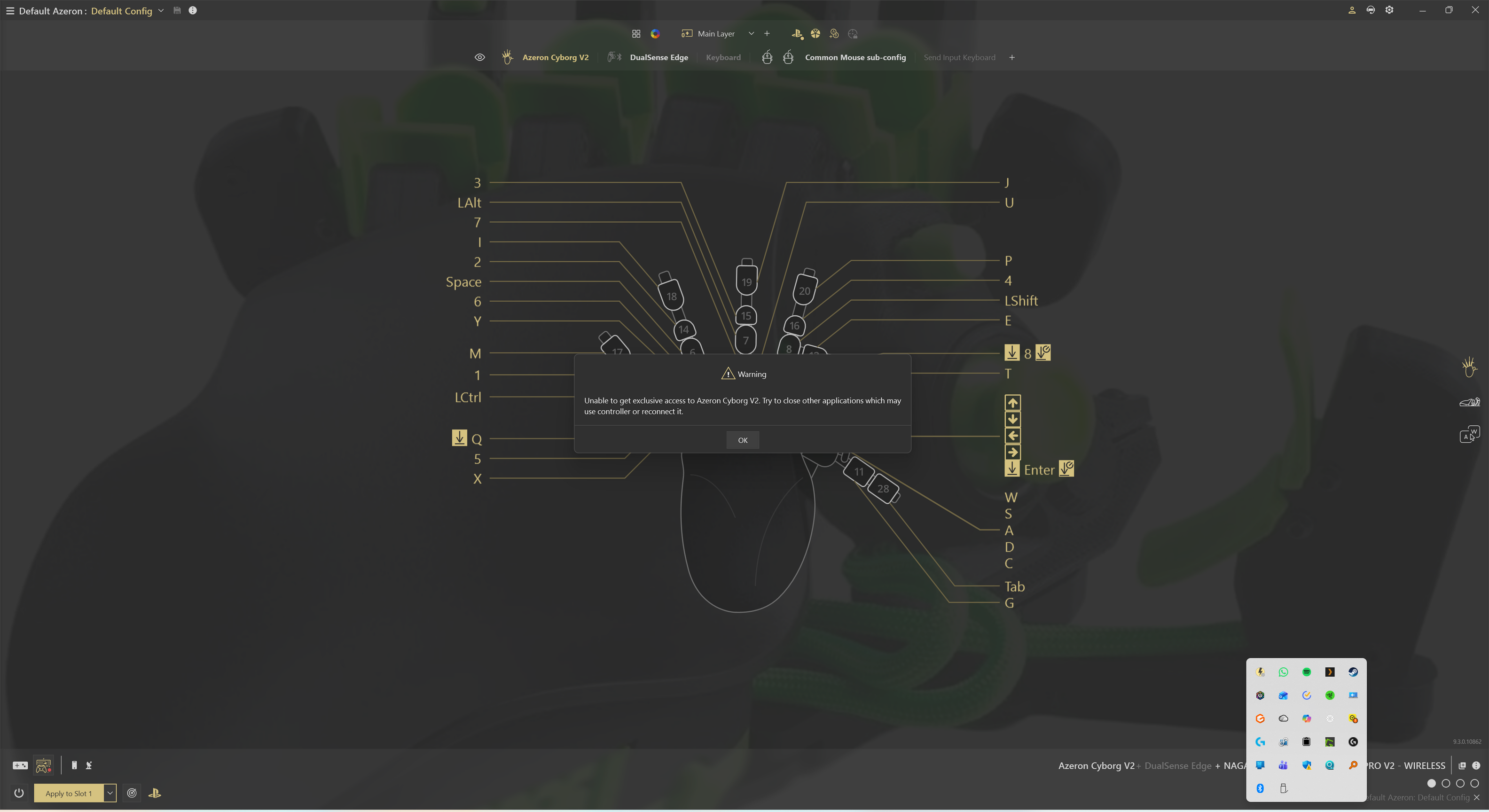

      Is there a way to download an older version of REWASD this new update is just giving me too much problems. It has also been telling me that it can't get exclusive access to my Cyborg 2 despite the fact that no other program is running that controls the cyborg. I have had to downgrade to version 7 just to use it without this new error that never showed up before. Is there a link to 9.2?
        Can you send a screenshot of this error?

            Here is a screenshot of the Cyborg error. Also when I reconnect the cyborg the red dot goes green but it is non-responsive when I click detection mode or use notepad to see the characters when I press them. I have attached a copy of my logs.

              Based on log analysis, your Azeron isn't responding to reWASD commands. We don't know the cause of this behavior, but it strongly suggests a hardware issue.
              What you can do:
              • Unplug all unnecessary devices and try connecting the Azeron to a different USB port.
              • Check the device's functionality in the Azeron's native software by closing reWASD and disabling remap.
              It's also important to check that the firmware in the native software is up-to-date.​

                The cyborg is fully functional in the native software. I have also connected the device to multiple ports on both softwares, the azeron's native software works consistently and the rewasd program still gives me exclusivity errors even though I have fully shut down and exited the azeron software. It is very strange, I was using the Azeron to play ME1:LE the day before with no issues. I have also shutdown any other program that could potentially take control of the cyborg and it still gives me the error.
                  We have rechecked CyborgV2 on our side and did not find any problems. Maybe you have some other remapping software installed which tries to access your keypad and causes conflicts.
                  I would first suggest to uninstall reWASD completely and reboot your PC. Make sure you don't have any older version of reWASD installed as well.
                  Disconnect all gamepads and run original Azeron software and make sure you have latest firmware installed: as of now it must be 100b.
                  Then install latest version of reWASD and, after reboot, check again. You can also try to make connection log in reWASD before plugging in your keypad, so we can recheck how it is recognized.

                    Hi, Thanks for your recommendation. I did what you suggested and still had the same issue. However, I went to windows settings> Bluetooth & Devices> view more devices, selected Azeron keypad and clicked remove; I then disconnected and reconnected the Azeron and it seems to have fixed the problem for now.
                    I have attached the logs to see if a cause could be found for future reference. I am interested in why this happened. I have used reWASD for years and haven't had an issue like this before.
                    Thank you guys/gals
                    Edit: I think what occurred was that I changed the port that my Cyborg was previously in (it was in a monitor usb hub) to the rear I/O port on my motherboard. Maybe windows did not update the address information or Azeron still thought that the previous address existed and it caused a conflict with itself.
