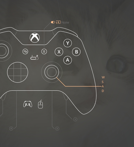

    reWASD doesn't know the fact you are driving a car, but with a little help from you, it is possible. I would like to advise you to create a Shift for your config. Choose some button you do not use and set it as Shift modifier with Toggle. In this Shift, set WASD to the Stick. In the game, you will need to press the Shift modifier button to switch to the Shift. So, once you are in the car, press it. When you leave the car, press it again to switch to the main configuration again.
      Thanks.
      It works only if I unmap the wasd in the shift mode
        Hm, you have mentioned that you want to emulate WASD - here's how WASD works. If you need Analog movement, the easiest way is to use the native gamepad stick.
        Still, I understand what you are talking about, and in fact, we are already working on the feature that will let keyboard mappings on stick work differently depending on the stick position. Stay tuned, it will be added to one of the next releases.
