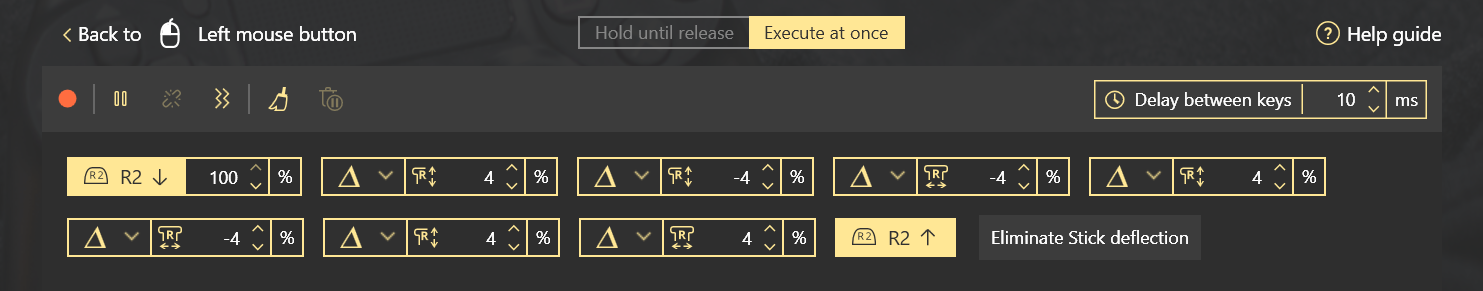

    I can do that. So, to mimick moving the right stick in a circular motion, enhancing aim assist, i could make a combo RU 4, RR, 4, RD, -4, RL -4, RU 4, RL -4, RU 4, RR 4 and this should be on a turbo so it is continuous. But the way it is now, I'd have to wipe out L2 all together or make a super long combo with L2 before everything in said combo.
    Have you tried the following combo? Once it is set to Turbo, you get both — Turbo for the trigger and continuous right stick motion:

                  • #24
                    the problem with this, r2 will have to be turbo'd. not a problem for semi auto guns, big problem for automatic guns. same thing if i attach combo to l2, l2 is just aiming down and off rapidly making it hard to kill anybody.
                    • #25
                      Got your point. Indeed, the only way to make it work right now is too create a long combo. We will take your suggestion into account, thank you for the details!
