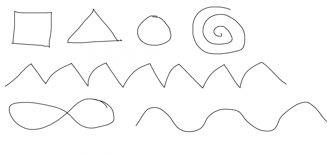

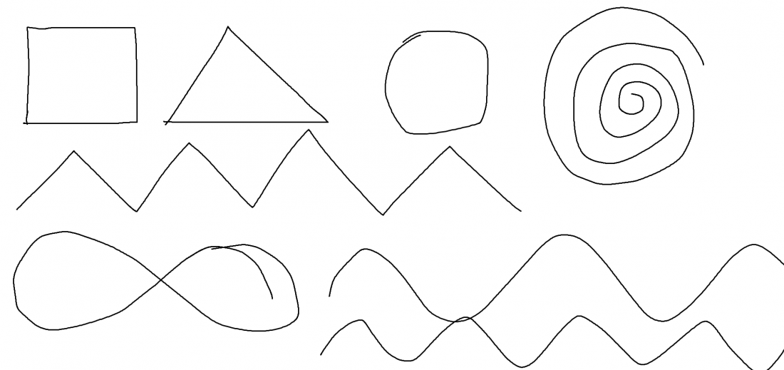

    To illustrate the difference between a mouse (1), Xpadder emulation (2) and reWASD emulation (3) I created these test images.
    Mouse (800dpi):

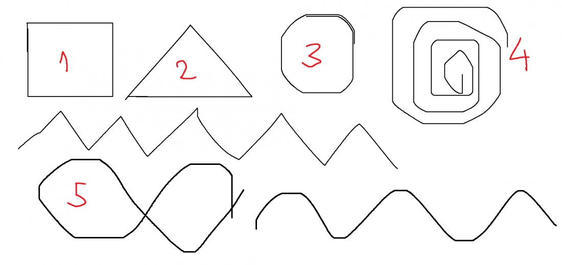

    reWASD (had to lower sensitivity as it was almost unusable for fine movement):
    Clearly something is wrong with those corners. Shapes 3 and 4 illustrate my point the best. Also Shape 1 was all to easy to draw and the lines went straight even though my hand did not.
    All that is to say that I'd really like to see a more "high fidelity" mouse emulation in reWASD

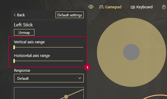

    Please go to Advanced stick settings and minimize the range on both axes like it is shown here:

      Oh wow, that has certainly improved the fidelity of cursor movement and my "circles drawing" ability
      The name of those two settings though - still not sure what they mean, just from their names.
      Could you please elaborate on the meaning of those two settings and also the curve from below? Or they are already documented somewhere?
      Assuming that is not the speed curve I'm looking for, is there any plan to have such a thing in the future? Maybe have this as another option and make it an actual curve (as opposed to segments) allow to alter it with 1-2 anchor points?
        Great!
        You can visit this guide to get more information about all advanced settings you see there.
        Axes range sliders allows you to set the range in which a directional mappings is emulated exclusively. The default values are great for WASD, but to make a mouse smoother, it is better to minimize both.

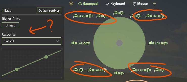

          So I'm using the RStick setting with zero range on both axes for Shift 0 to make the mouse smoother, but then when I tried to set different bindings for the same stick on Shift 2, it no longer allows to set axis ranges and I get combined keystrokes for diagonal directions. This looks like it's trying to mimic WASD behavior, can it be avoided?
          Shift 2:
          Click image for larger version  Name:	shift2.png Views:	6 Size:	98.9 KB ID:	219451

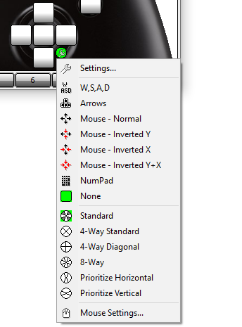

          Again, Xpadder example (I know ). I'm looking for something like this, individually for each Shift:
          Click image for larger version  Name:	xpadder_rstick.png Views:	6 Size:	26.3 KB ID:	219452
          Ideally all of the 8 zones (4 directions + 4 diagonals) would be configurable, with range from 180 to 0 degrees per axis. For example 0 degrees for Horizontal axis would mean you only get Up/Down bindings.

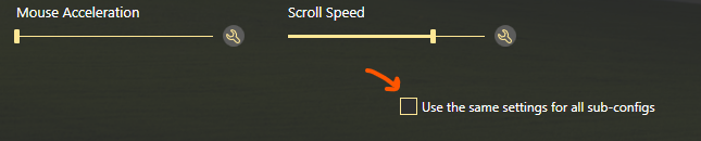

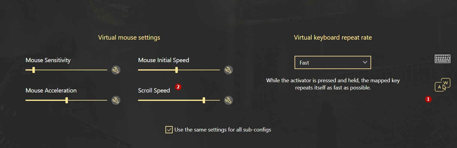

                  3. There is no Turbo for scroll, yep, but you can tune the Scroll Speed (2) in Virtual devices (1) settings:
                  4. You can set custom 2- or 3-button hotkeys for Slots in Preferences, Slots tab.

                    3. This is cool, but looks like a found a use case even for Scroll with Turbo I have 2 buttons which I use for "regular speed" scrolling and two other buttons for very fast scrolling. Technically this could be accomplished by using a separate shift and having different scroll speed (?). Not sure what the setting below means by "sub-configs". But anyway, I would prefer to be able to have different scroll speeds on different buttons as I tend to keep my shifts logically separate for actions which are related. And I'm afraid that 4 shifts might not be enough for me in this case

                      3. The settings couldn't be changed for a Shift, it works for the whole sub-config (the one for a Gamepad in your case).
