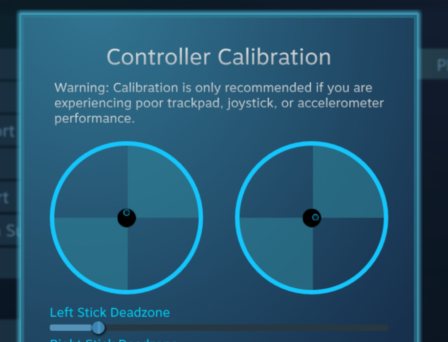

    I'm just really curious though because both Rewasd's toggle gyro mapping on stick and my Steam Input's disable gyro with virtual DS4 have the same problem where it wouldn't work reactivate gyro after deflecting the stick sometimes. Using steam's controller calibration, I thought the problem might be what I'm seeing there where the deadzone color would stay red sometimes after deflecting the stick no matter what deadzone size, so I figured there might be a potential correlation here. Anyways, sorry for joining me on what might be a wild goose chase.

    Thanks for the explanation. I have checked it with Joy-Cons remapped to the virtual DS4 controller, and I can't reproduce the issue you have. Here is a screenshot from my Steam client:
    Click image for larger version  Name:	0e21a1f25d.png Views:	0 Size:	540.2 KB ID:	223555
    Once I have just opened it, both circles were red, but if I deflect the stick slightly and leave it back, both circles become black.
    Here are my thoughts now:
    We have a small issue with the dedazone for the virtual stick, it is not saved to the config now. The bug is confirmed, and we are working to resolve it and hope to release the fix in a week or something like that. I am pretty sure that enabling a bigger deadzone should fix this issue.
    If it doesn't work, I am not sure how we can help here, because it seems to be the specific way of how Steam detects the sticks. Usually, we check the configs using this tool, and I do not see the issues with the virtual controller here. Also, you are using the outer-ring binding, and I am not sure if it is possible to lower it to zero with that slider.
