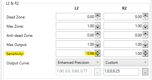

    First I would like to thank you guys, reWASD is amazing!!!
    But one option that I miss (I used to be a user of DS4Windows) is the option to set the sensitivity of the Triggers (L2 / R2), with this option I could set how much of the trigger were pressed when I pressed 100% of the trigger, very useful for racing games.

    Please think about it.

    At the moment, you can set the deadzone for a trigger from both sides (it means that the trigger will start working when it is half-pushed, for example, and will reach the max value while you haven't actually reached it).
    The thing you describe seems to be an opposite one, right? A kind of "anti-deadzone". We have this one in our to-do list, but it won't be ready in the upcoming version. We will definitely start working on it in reWASD 5.6. Stay tuned!

      Thanks for answering.
      Yeah, my english isn't good enough to explain it, but yes I think it's an anti-deadzone thing. When you press 100% you can choose how much the trigger presses.
