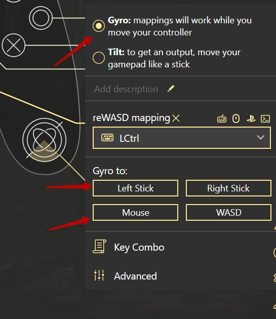

                        We are happy to know that you get used to our UI. Yep, it is not the same as Steam, but hope with a bit of time spent here, you will find all needed things.
                        "Spring mode" for a gyro (when the emulation stops when you stop rotating your controller) is Gyro mode (you can select it from main window, where you add mappings to the directions).
                        "Non-spring mode" for a gyro (when the emulation stops if you get your controller back to the deadzone) is Tilt mode.
                        In reWASD, you can add mouse or stick mappings to gyro, so it seems the answer is yes, the game will see a stick.
                        Here are all those ones:
                          Yes, Gyro works very well for me when i map it to mouse and i use "yaw" in the global reWASD options. But, if i map it to "right stick" for example, it barely works, but i admit i didn't played a lot with the sensibility options since i normally set the gyro to mouse mapping. Would be mostly a "cherry on the cake" option to help new people setting up their controller to try out gyro without having to create a full K/M mapping or even worse trying to do an hybrid configuration where most games will just mess with onscreen glyphs (or worse). What i asked was if is possible to still map gyro to mouse but, masking/hiding "mouse" so the game thinks is a stick and doesn't try to change the onscreen button glyphs evey half second. Curerntly i'm doing the tests with "remnant: from the ashes" because is exactly that kind of game where mixed inputs are a mess (just do a controller full mapping with gyrop on mouse and you will see what i mean) but, there are really really lot of problematic games like this (or even worse) out there. Ofcourse, full k/m mappings will solve most of the problems but, this is mostly for advanced users. New players that "want to try out all those gyro things i see on the web" will just find it problematic/not worth if they have to tinker 2 hours for every single game they want to play just to create a full k/m configuration. At least, reWASD community has made a lot ready to use configurations
                            Yes, remapping Gyro to controller should be much better in the games that support a controller.
                            I hope you will find your perfect settings for this type of mapping
                            We will also try to re-check the game to see what happens with a virtual controller there.
                              Also, I would suggest you to check Tilt mode too, in some games it is a better option, because Tilt is actually a Stick.
