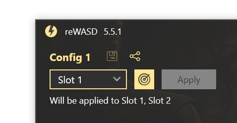

    4. reWASD marks the slots to which the configs will be applied:
    Click image for larger version  Name:	7e8665d465.jpg Views:	0 Size:	21.8 KB ID:	221478
