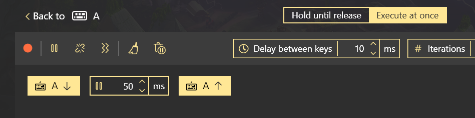

                You may try to remap your A button to the following combo:
                ...and then Mute its native behavior. The same should be done for all buttons used in Shortcut.
                Then, when the button is working "normally" — pressed alone without other Shortcut participants — it will be pressed the exact amount of time. I hope it may help in your case.
                Please try 20-50 ms pause and check how the game reacts.

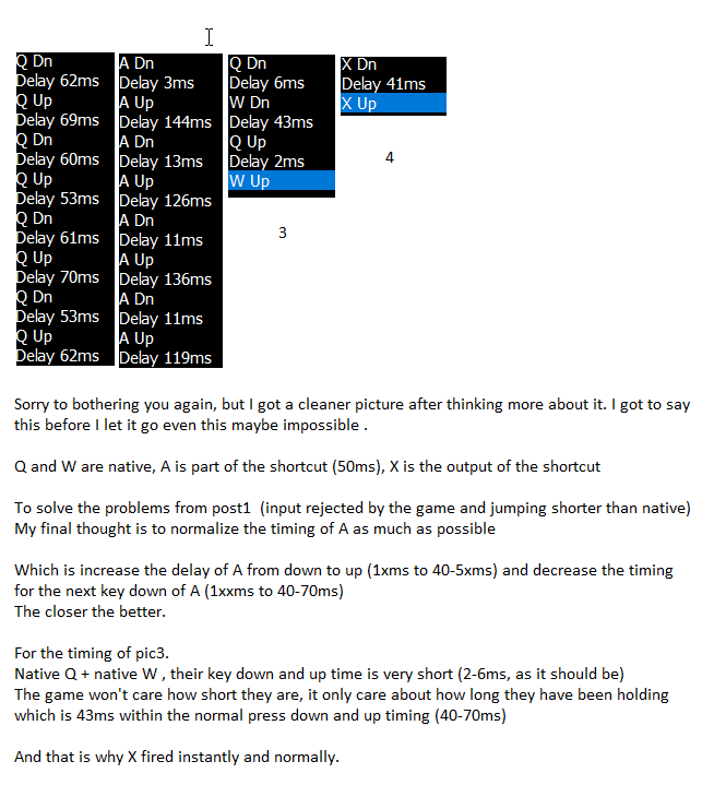

                          The problems (bad keys timing and pacing in general)
                          1.Attack may charge itself even you are not holding the key
                          2.Jumping is shorter than native
                          3.Jumping input can be eaten , and happen a lot
                          4.input blocked or delayed

                          Keep in mind that shortcut mode will always mess with the timing of the related keys

                              If you use the hold until release mode then the timing will turn back to a mess ...
                              Hold until release mode won't work for your case. You need to create Execute at once combo only. If you choose Hold until release, then you get an ordinary mapping, it is the same if you do not use the combo at all.
                              I think the issue is connected to the timings only. The game waits while you press the key for some time, I think it is about 20-30 ms, this is the approximate time required to press a key quickly physically. If you still get inconsistent behavior, you may need to try different pauses (duration of the pressed key).
                              When you use Shortcut, reWASD replaces the normal button press to the Execute at once combo that lasts 10 ms only. And it seems it is not enough for your game.
                              Please check it with Execute at once combos. I hope it should solve the issue.
