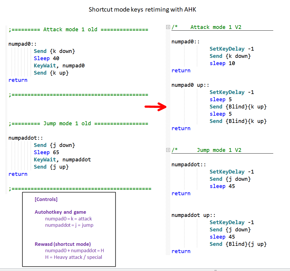

      • #18
        You guys can look into this
        https://www.autohotkey.com/board/top...ording-script/
        This one is basically shortcut mode but written by AHK.
        The related keys will keep a timing which is very close to native(the game react normally) and it let you to set the timing of keywait/delay you need.
        Sadly this script got it's own bug (holding one of the related key for a time and press the other one will mostly trigger the target key...........)
        But if it give any idea to improve the key timing of shortcut mode then that will be great.

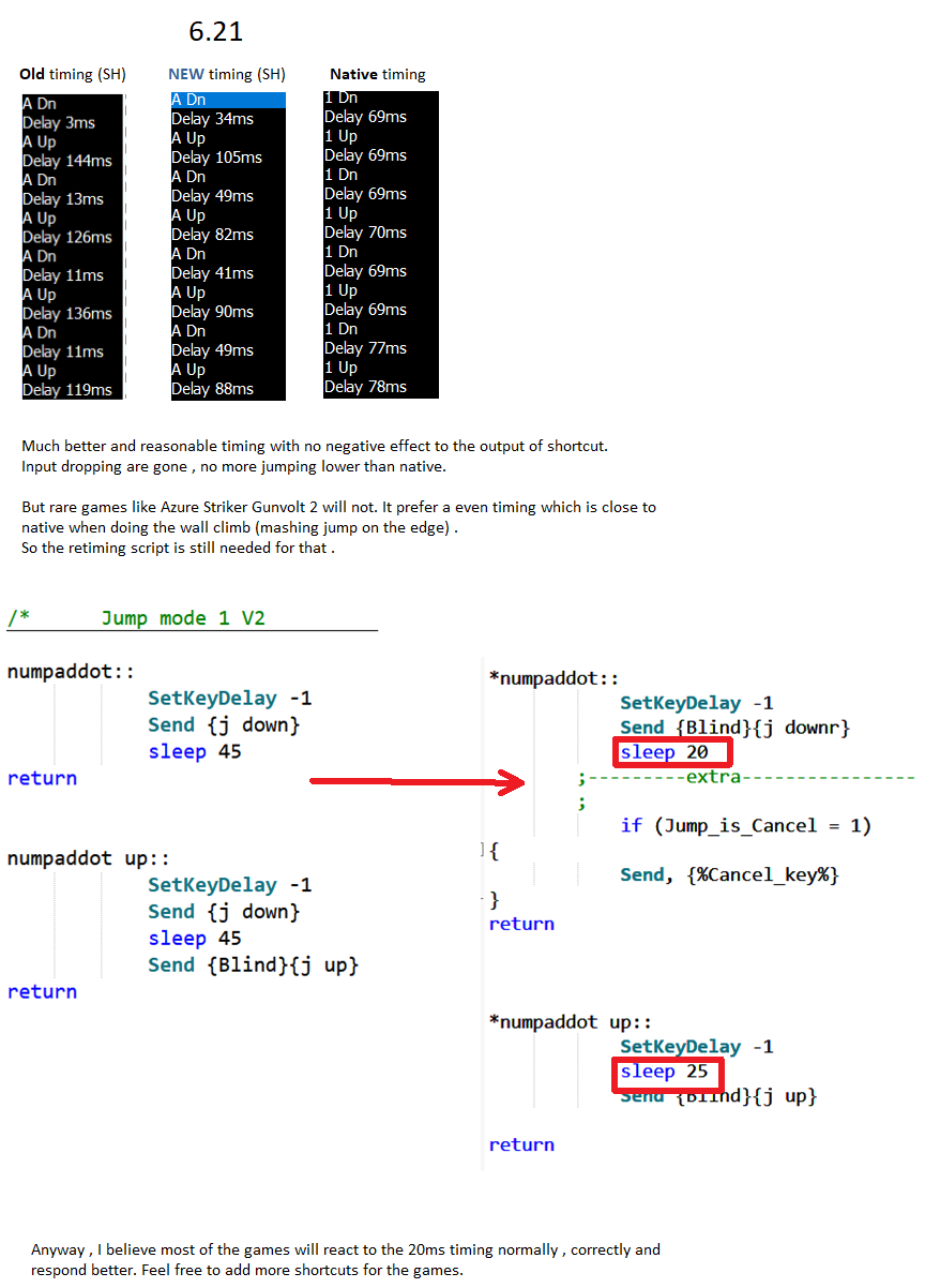

            Just upgraded my retiming script for the shortcut mode keys to V2.
            1. The Jumping height are now matched with the native jump (tap/hold , from 80-90% to 100%) , you can't tell the different and it fixed not just one game.
            2. Input blocking are fixed. (Found this issue after finished Forged In Shadow Torch with keyboard + shortcut mode )
            With the old script
            Holding JUMP(j) > Holding Attack(k) > Release JUMP > Press/Holding Jump (< this input is blocked until Attack is released)
            I am happy with the shortcut mode + the retiming script V2 , so no hurry take your time.
            • #21
              I am not to fluent with AHK, and so I do not understand some things. If it is OK, please describe with more details. I can see that you send 2 key-up events for K (attack). You are sending to of them to be sure that the game understands the the key is released? It is not possible to send key-up only event in reWASD, our Combos are working in a more native way
              As for the final configuration, it seems that using the script, you bypass the delay reWASD adds to the buttons used in a Shortcut. I assume if you press both button together, you get everything at once — K, J, H. This is not allowed in reWASD because our idea of the Shortcuts lets you get a Shortcut mapping without the original input from both keys used there.
              • #22
                I know only a bit about AHK, the whole thing is basically trial and error thing.
                [I can see that you send 2 key-up events for K (attack).
                I don't trust anything , so i force it to do twice. It won't hurt
                BTW, the numpaddot up selection are the most illogical thing of the script. It will produce extra J when ndot is pressed, but all the games i tested will treat it as one press, with or without the shortcut mode on... That thing will fix the height of the jumping. So... Oh well...
                I remember you can do key-up thing in rewasd, anyway...
                Actually i don't think about that one. But by the power of rewasd it will only output H.
                The fact is Ahk will always be the last one to modify/process any last output from any device or software.
                Here is my guessing.
                At the Rewasd side , it only handling the n0 and ndot for the shortcut and will not affected by any remapping of ahk. (No just because it got a higher priority but also ahk are not a Physical or Virtual device.)
                When the shortcut is triggered , n0 and ndot are chorded (rewasd magic). Ahk got nothing to remap at that moment. So H will be the only output.
                KB hardware > Rewasd output > AHK output > Final output
                1 native > set 1 to 2 > set 1 to 5 > press 1 = 2
                1 native > set 1 to 2 > set 2 to 9 > press 1 or 2 = 9

                    • #25
                      Please check the latest reWASD 6.2.1 version — it will let you minimize the Shortcut Press time up to 20ms. Other novelties are described in our announce post.
                      • #26
