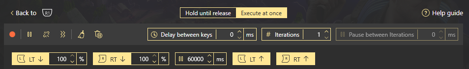

                In this case, set up a [Combo] like this and set the [Toggle] flag for it:

                [Toggle] flag will run the [Combo] until you press remapped button again. Pause in the middle will make sure the buttons are held for at least a minute before [Combo] is repeated.
