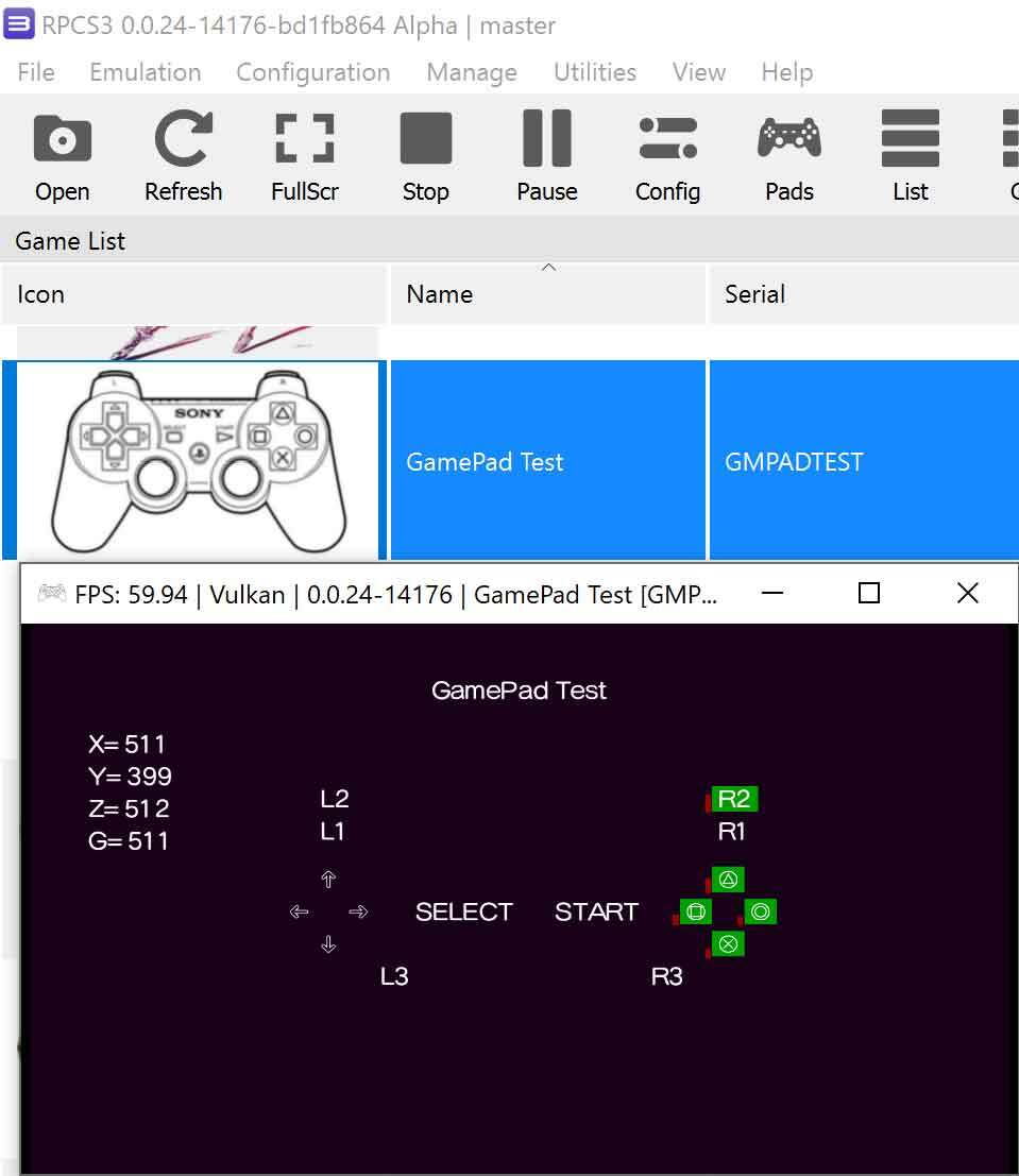

      Screenshot below is taken from RPCS3 GamePad Test using actual DS3 as Virtual DS3 (you can see pressure sensitive buttons working nicely). You can see values for gyro and accelerometers in top left corner - hopefully those will work in near future.
      Thanks again for considering this.

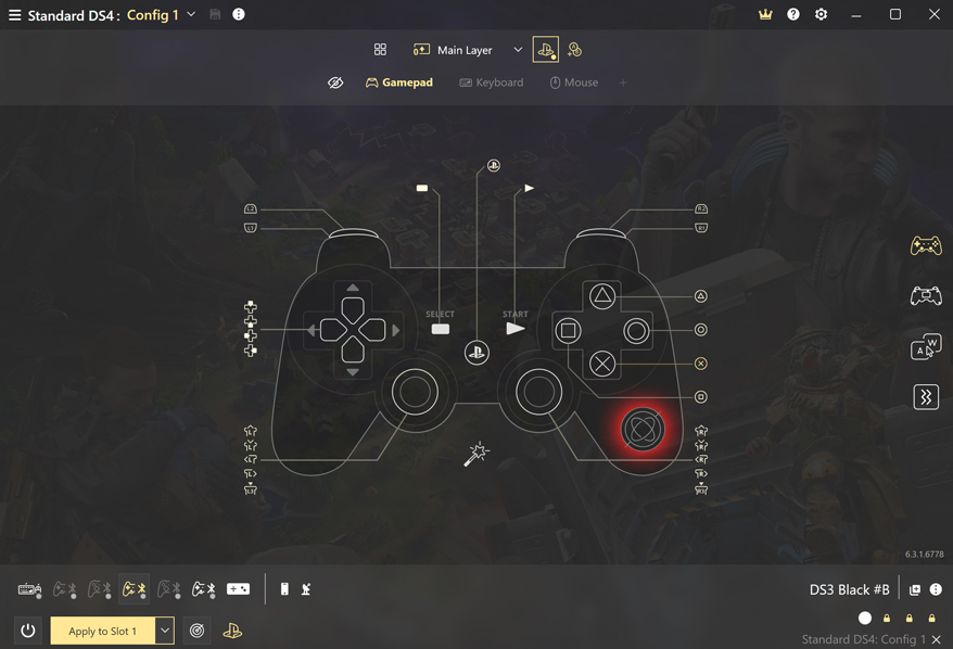

        Yeah, I saw in RPCS3 "motion controls" calibration that emulator has four values X, Y, Z, G for accelerometers, so I think it is possible at least to control camera (right stick) or being steering wheel with this support. Like they did it there:

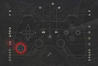

            Something like this

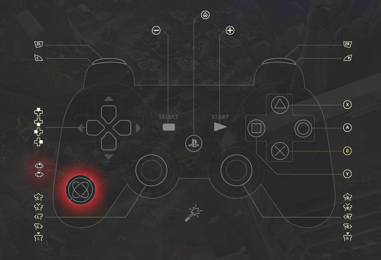

                        ​​ Click image for larger version
                          It is generally impossible to map DS3 gyro to DS4/Switch Pro because it basically has 'none': gyroscope in DS3 is represented by just one low resolution Z-axis (yaw), so no pitch or roll. We can map just 3 axis of accelerometer only (for tilt, shakes etc), but note that accelerometer in DS3 has very low resolution and lot inferior to one in DS4 or Switch Pro. The experience would be subpar.
                          Hmm, so I think it's good to use gyro in one axis. Assign tilting to Left Stick's left-right, Right Stick's left-right and mouse move left-right. It will be good enough. I can use controller for driving like it was on the video which I have pasted before and small helping with aiming in shooters (usually I have problem with left/right calibration, not up/down so it will help anyway).
