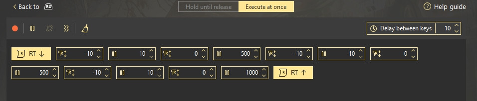

    You can create a combo to do this. Here is the one that I think will work:
    Click image for larger version  Name:	6bb7e3c079.jpg Views:	0 Size:	41.7 KB ID:	217051

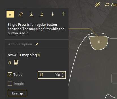

    You will need to add Turbo to it too:
    Click image for larger version  Name:	1b4fd44c90.jpg Views:	0 Size:	28.3 KB ID:	217050
    Once you press a trigger, you get not only trigger press but also Right Stick that goes down for 10% and gets back to the normal state after just 10 ms. Next half of a second you get trigger only. Then, one more stick movement and pause again. You may add a long combination of pauses and stick moves and finish it with trigger-up node.
    The combo is pretty long (actually, it needs to be even longer) and so we need turbo. With turbo, the combo will execute from the beginning and will stop once you release your physical trigger. So you will get a single shot with recoil control if you press and release trigger at once and you will get several stick movements if you press and hold your trigger.
    Not sure about frequency and pauses, it is better to test in game.
