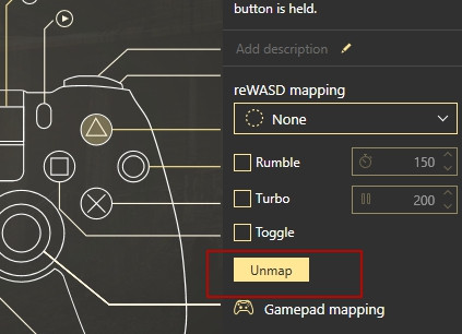

    Aaaaaand new problem. ACC has no option to disable controller support and actually quite a few of the settings in the game for gamepad are very important, but it automatically overrides reWASD and sets the paddle inputs to ABXY. It doesn't change the reWASD profile, just the game won't use the reWASD bindings instead of the gamepad bindings for some reason.
    • #17
      I think you need "Unmap" on this stage. This will eliminate the native controller behavior:

      • #18
        I'm one sep ahead of you. If you watched the youtube video I made and linked previously it shows I have all 4 paddles properly "unmapped"

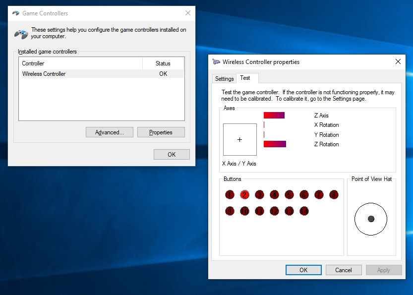

        • #19
          Ok, great!
          Could you please then check in system tool how the system sees paddles after the reWASD remap is on?
          Type joy.cpl in the Windows menu bar and open the suggested tool. Locate your controller, click Properties and try to press one paddle by another. Are any buttons highlighted?

            Also, I have a few more questions for you Unfortunately, we still can't reproduce the issues you have, so we will need your help:
            1. Could you please open Xbox app to check the firmware version? Please send me a screenshot of how your Elite controller is shown there.
            2. Could you please try different connection types? Am I right, you connect your controller via USB? Could you please switch to Bluetooth or Wi-Fi adapter, re-Apply the config and try again?

                • #23
                  When I open joy.cpl and try the inputs on an xbox-accessories profile (meaning I mapped the paddles to face buttons) and it shows them registering as face buttons. When I use the reWASD profile the paddles show zero input on joy.cpl I'm assuming because it doesn't recognise those as extra buttons. There's like buttons 1-10 and the paddles don't light up any of those if I have my reWASD config turned on.

                        • #27
                          1. Please check Xbox app settings. It seems that paddles are mapped to something but you should bind them to "Unmapped" and save this configuration to all slots.
                          2. Check whether you have "Unmapped" option checked in reWASD for all the buttons you have mapped to some keyboard actions.
                          • #28
                            Thanks for the trouble shooting guide; finally (remove all bin2 files, again) my paddles are now recognizes as keyboard input ♥
