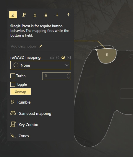

              0. Remove Turbo from the trigger itself and Unmap it:

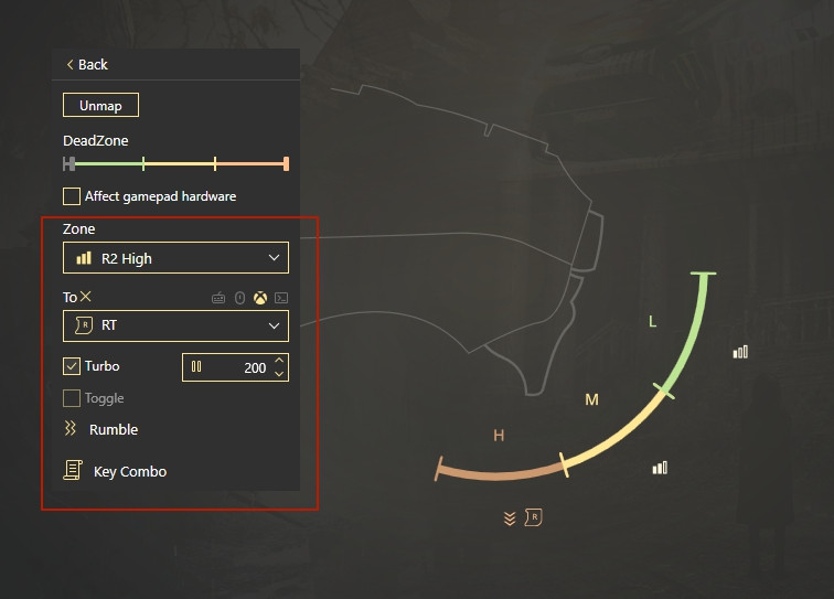

              Then,
              1. Go to zones, check High one and set a trigger + turbo her.
              2. Otherwise, check Low zone and set a turbo for this one:
              In both cases, you will get turbo only for a limited travel zone, either when you slightly press, or when you do a full press.
