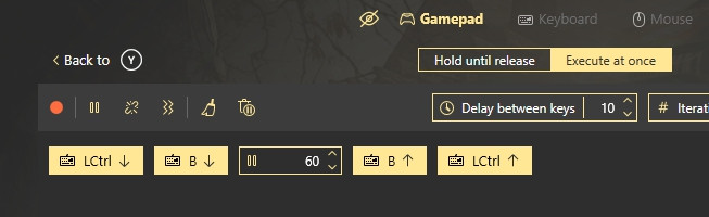

    In the meantime, do you need your combo to be held while you hold a button? Or maybe just some exact amount of a time?
    In the second case, you may try something like this, add a duration of the combination and use it in Execute at once mode:
    Click image for larger version  Name:	ecfbb26e1d.jpg Views:	0 Size:	29.7 KB ID:	218989

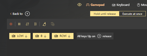

      Yeah, the problem is that I need it to be held. Glad to say I actually found a rough workaround. Now, if you were to add the right control into the end of the aforementioned sequence (so now it would look like LCtrl+B+RCtrl in "Hold until release" mode), that sequence would start AND end with a modifer key. Which works perfectly! Hopefuly someone finds this useful.
      Obviously, not every game would consider left and right modifiers equal and as such, we need the posibility to customize the release order of keys.Click image for larger version
